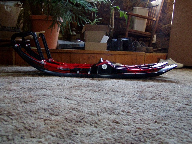

I like these skis for my RX-1 mountain with a 162" track. Great trail performance if it's not rutted up and icy (in these conditions it's an interesting ride with 2" paddles :exc: ). And the powder performance is awesome
They are PPD skis (X-MT models). PPD is the company that makes the precision skis for BRP. The MT is the mountain designation. They also make a X-TR2. I'm assuming that would stand for "Trail" (version 2).
Here's some pictures of the X-MT models before installation and one with them installed after the sled was all washed, waxed and alluminum was polished.
