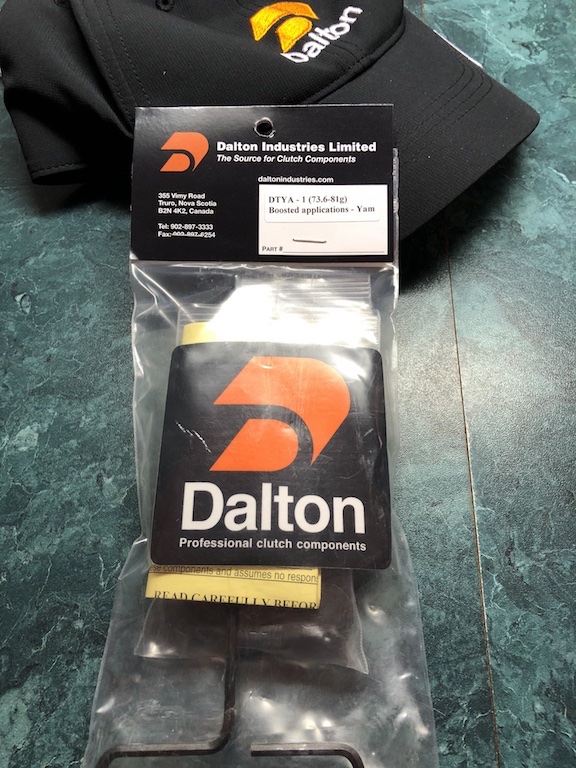

I run the DTYA-1's.....Approx 77.3g

i think those are the weights i actually have , what are you running for springs and helix? i have a big track and its geared different but should get me close. i have a 153 2.25 with i think gearing 24-50

I have a 129'' w/1.25 rip2.thanks Dan
-Dalton bk/red primary(48/120kg)
-Dalton DTYa-1(set to 77.3g)
-Thunder Products rollers(14.8mm)
-Thunder Products glide washers(2)
-Dalton B/O ('19 version@80 degrees)
-Hi Torque rollers
-Helix's: 39/35 and also 37/35( I ride mostly tight trails-corner to corner spool most important)
-Ultimax Xs825
-Back to stock gearing this season(21/41)
Running lowered offset as per Hurricane Alignment bar(cut down secondary), Shortened float plug, and cat deflection shims. Will see how this does on belt life this season with all the changes.

my luck i have dtya-3 and qay-62. neither will work lol i also have some super tips i belive they have a b stamped in them ill have to check weight
