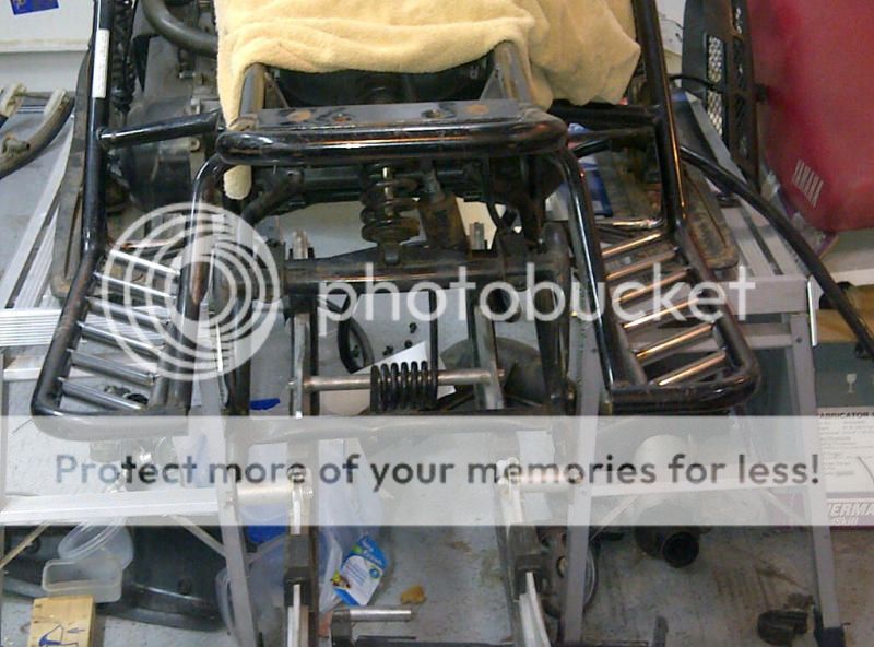

well running boards done on one side......used light wall 3/4" exhaust pipe......better than what was there.....rough cut the plastic out....need to true up the edge and melt the burrs off....

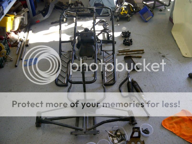

Well all apart.....finish welling up the boards and tunnel mounting tabs....sand blast and powder wrinkle black....need to make a cross shaft and spacers for the arm that mounts to the skid....need to make a protector sheild for the bottom of the gas tank.....

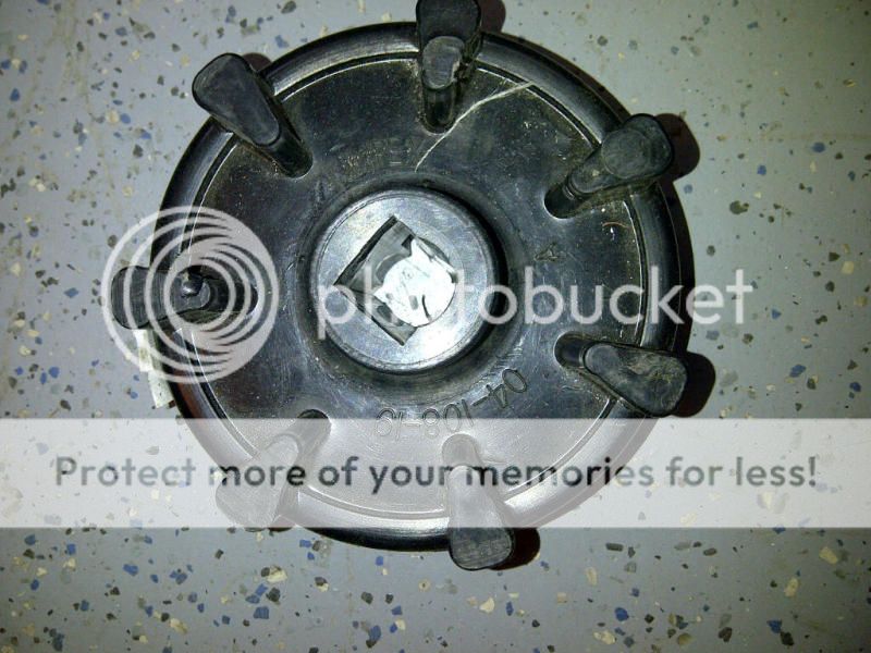

How did you cut the driver so that it will fit the square track shaft? Nice job on the boards BTW.

Bought like that....it's a kimpex driver for a older bravo 2.52 pitch
