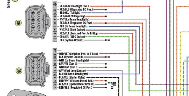

Red/Violet Normally closed switch
So just getting back at the kill switch plan. So when the switch is normally closed that means if I were to remove it and just connect the two wires together that should do it?
Correct.

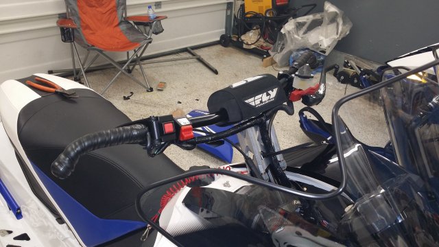

Why? Going for the vintage look?

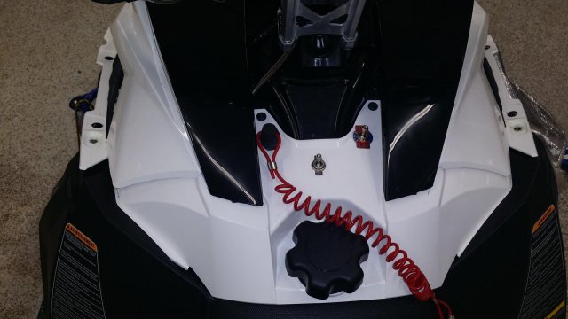

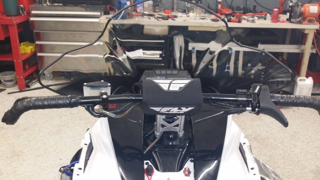

No less stuff to break. this was one of our XC sleds. No more ignition switch the front red button starts the sled as well.
Yea WOT did that to his. Never got to ride with him this season to try it out. It was a nasty job though - wires everywhere
