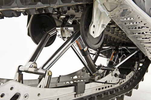

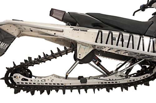

The pictures show obvious differences in shock absorber linkage geometry as well as chassis- and rail mounting points. Rumours in the other thread says it is a BDX AC Float copy. Who has got experience of this type of rear suspension...? Pros and cons compared to the standard rear suspension...? Pros and cons compared to other aftermarket rear suspensions...?
Also, is the claimed 25 pound weight reduction trustworthy...? My impression is that the standard versions of the parts included in this kit are not much more than 25 pounds in total...?

Alatalo- My only experience is with KMOD using the stock rails- weight saving are more than real. Adjustablity is much more in tuning. I ran it all last season and I'm now adding the OFT reail extension to 162" and 8" rear bullet wheels and 7" upper wheels. I found that the forward 5.25" idler wheels, I bent axel/bolt and will be replacing both the wheels and axel design to something a little more robust. I've been very happy with this set up. If I had to do it over, I'd proberly would have gone with some better rails. I have a tunnel exhaust and not once did I bottom out the suspension.

The ones of you that did see this at Hay Days, did you notice if the front swingarm needs new tunnel mounting points...? From the pictures it is obvious that the rear swingarm is using non-OEM mounting points, but what about the front swingarm...?
Saw the sled at big east show and it does not use stock mounting points.

What yami should of looked @ was the 2 big pieces of steel of rear suspension drop bracket! Make it out of alu already. They keep using that horrible bracket since the day of the RX1.

The pix on the yami site show the skid mounted in the stock holes on the rails and tunnel.
I asked the manufacturer about this. The front swing arm as well as the rear swing arm use non-stock mounting holes in the tunnel and in the tunnel drop brackets, but the stock reinforcement plate (where the front swing arm is mounted) as well as the stock drop bracket is still used.
