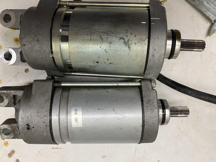

below is my used oem from the 06 vector on the top and what I think is an aftermarket from my 10 Nytro notice the flat sealing ring on the starter drive, and also the lack of markings on the case on the shaft side.
