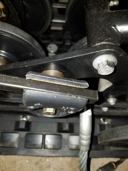

A little hint if you haven't already seen this but take the plastic spring holders out and slot the top just enough so you can "snap" the springs out of them so anytime you want. Then to remove skid you can just pop them out and bring the long end out past the idler wheel and down to unload skid. Saves you from having to remove the idler wheels each time. You may have to lift back of sled or put a jack under the track in the back. You can then collapse the rear shock to make it easier to get skid out.

Turbo flash, have you ever had issues with the spring trying to jump out of that slot?

Never. Been doing this for 25 years on all my sleds. Have never had a single time when spring came out. The spring has a ton of pressure pushing into the holder so it's not gonna come out.
Then they are getting cut the next time the skid is out. Thanks

Measure the spring diameter. Cut the slot a little narrower than spring diameter.
