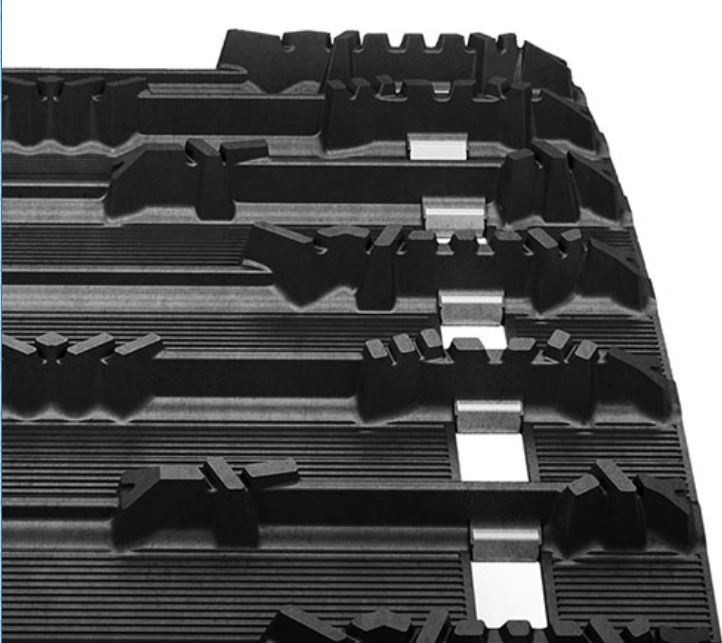

Has anyone done or does anyone know if I'm able the trim the tips of a 1.25" Ripsaw track lug down to a height of 1", without compromising the integrity of the lug?
I'm just not sure when cutting the tips off if I'd be opening up "seams" of layers of the rubber, or if the lugs are completely solid rubber.

The Ripsaw can be cut down but it will be time consuming and can be a pain due to the individual tips of the lug as compared to the Ripsaw II track which has solid one piece tips:
