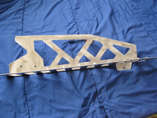

So...I used to have Better Boards on my sled, but they cracked after about 10 rides. I e-mailed them to see if they would do anything for me, but never heard anything back...so I made my own and incorporated an M-10 mount into them so that all my M-10 mounting brackets could stay outside the tunnel to allow for a 16" wide track.
Here's some pics of what they look like before I put them on the sled!!
I'll post more pics when it's all back together again

Excellent job
Climbmax
Very nice

OK...so I just finished installing the M-10 skid with my latest creations Everything worked out perfectly...thanks to Trevor at Mac's Machine in Sicamous for the specs on the 159 skid w/162" track...and thanks to the internet for the free CAD program I downloaded to design the pieces.

Nice looking boards, I like alot!

What about putting grips in the front too??
How do you like the m10?
HRT Offroad
akvector said:What about putting grips in the front too??
I thought about putting grips on the front two holes, but the foot pockets are pretty tight as it is. After trying it...I actually prefer not having traction up there!
I haven't got out with the M-10 yet, but going out for 3 days this weekend...I'm sure I will love it...especially combined with a good track. I think that is what the Nytro needs...a good rear skid and a little longer - quality track!!
