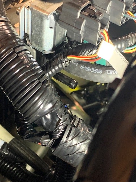

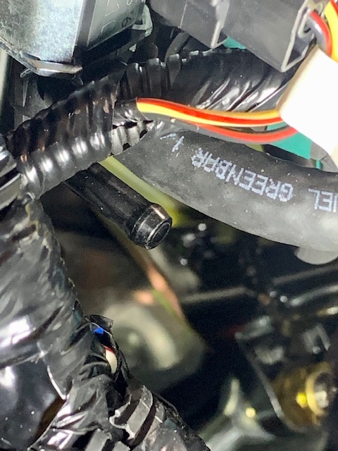

Yes. Mike has been doing this disconnect for awhile. I will check and see what they did on the 2022.. I never had a freeze up in 13K miles on my 17 but its sounds like the line was freezing up when it was connected to the airbox. I was going to try a WAI and they all have 2 nipples for 1/4 hose lines.. The guys making the WAI warm air intake(mikes words) are not aware of the changes either.. They all have two leads on them
jonlafon1
- Aug 18, 2014
- 4,303
- 3,349
- 2022 Sidewinder LTX_SE
2024 Catalyst RXC
2022 no hose.
Mystery solved.

lol yup , are u putting one on or leave it?2022 no hose. View attachment 163676View attachment 163677Mystery solved.

Leaving it. Unless someone can tell me why I need a length of hose on it?lol yup , are u putting one on or leave it?

My line froze last year and I couldn’t figure out why I was down on boost. Someone on here told me about it and shared the technical update that removed the line completely on 2021’s. So after thawing the line out, I then removed the hose to the air box and bought the plug to cover the nipple. In looking at the technical update manual, the hose was completely removed.
