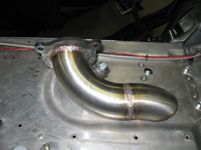

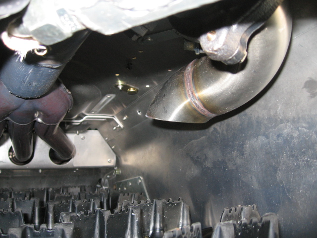

can any body tell me want size pipe is coming off the turbine side of the nytro kit, I am waiting for my kit and would like to order up some pipe to do the under tunnel dump, and is it stainless, thanks.
2.5 od.......kinda like this?

thanks Randy thats what I needed, kit should be here next friday, so I am tearing the sled apart now so I am ready for it.from the picture it doesn,t look like you are running the under tunnel heat exchanger.
Likely he isnt running the yami cooler since he has a CR tunnel with coolers
