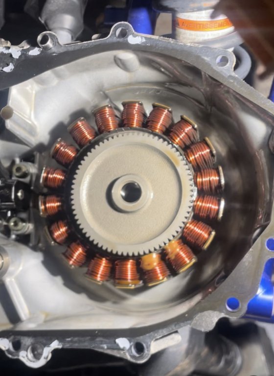

There was no burnt on the stator when I changed the cps and the battery was holding so I don’t think it is the problem. Here’s a pic of it. The weld in the cps wire isn’t my principal suspect anymore, I measured the resistance on the cps and it is the same as I measured when I got it.Are you sure the stator is okay?
- 5,714
- 4,312
Recheck your work. Did you secure the wire(s) properly inside and outside of the engine?
