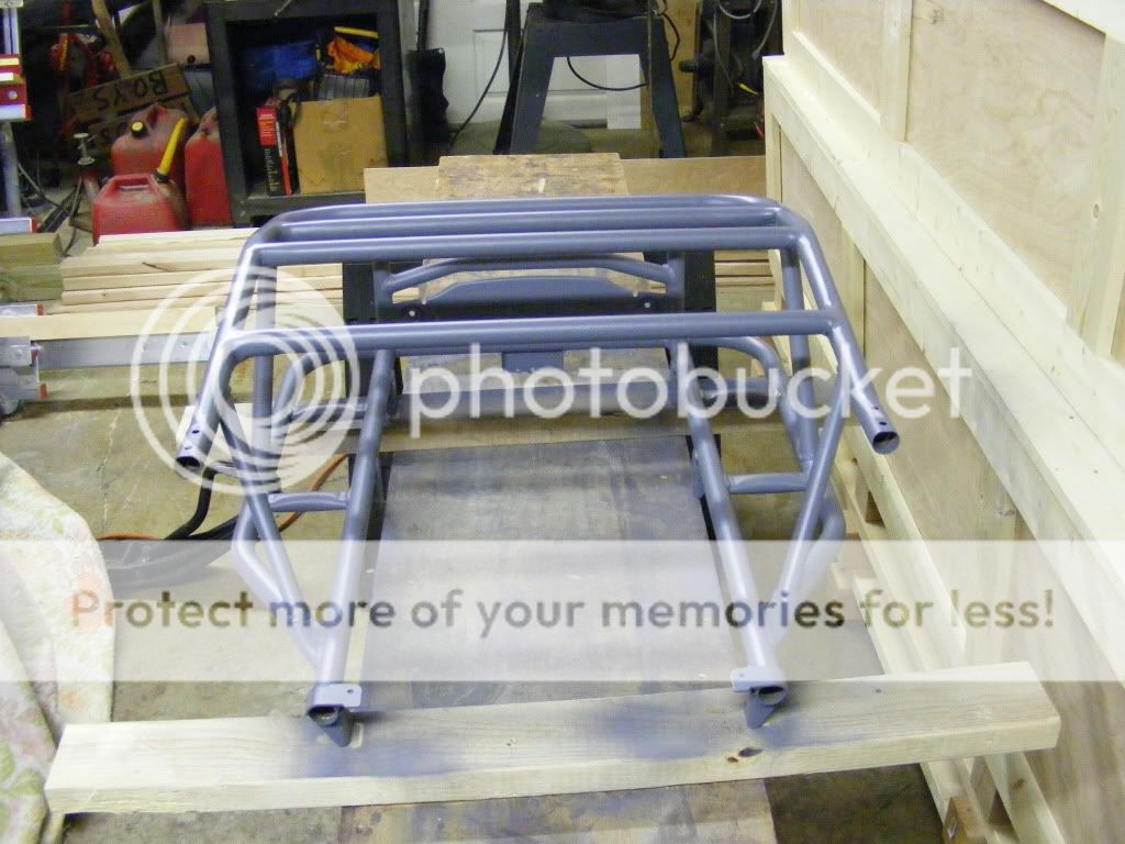

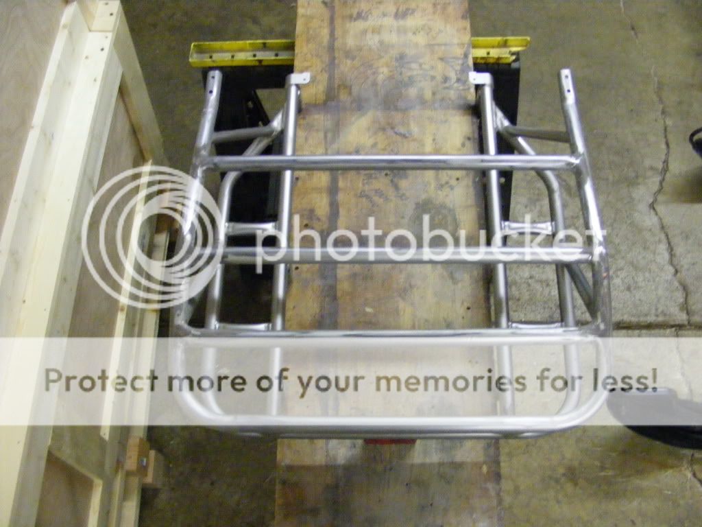

THIS IS THE RACK OFF OF THE SLED........DUHHH I WELDED 4130 STEEL CROSS MEMBERS ACROSS THE ORIGINAL RACK
THEN I SANDED IT CUZ MY WELDING LEAVES SUMTHING 2 BE DESIRED AND PRIMED THE RACK
THEN I PAINTED,WET SANDED,AND PAINTED IT AGAIN USING RUST OLEUM PAINTERS TOUCH 249128 ALUMINUM PAINT IT MATCHES THE YAMAHA SILVER REAL CLOSE.

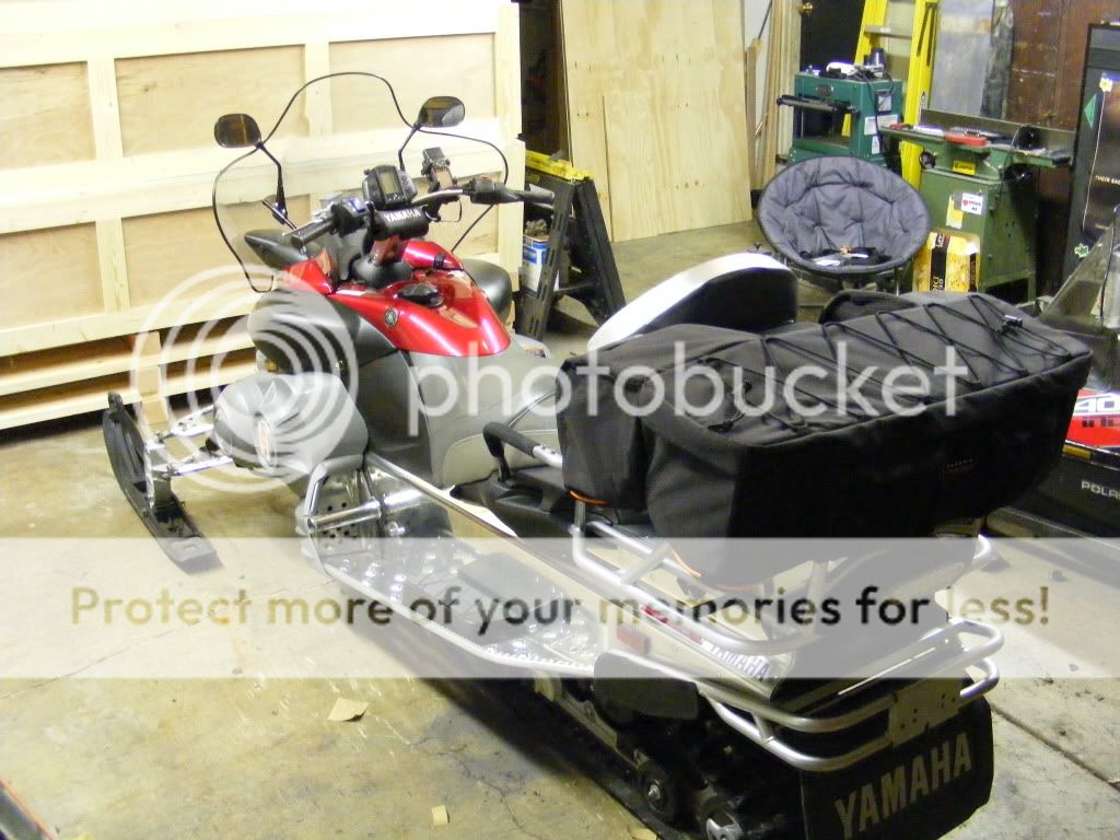

THEN REATTACH THE RACK 2 THE SLED,PUT THE REAR SEAT ON N GRAB A BEER N CHANGE THE CD....THE HARD PART IS ALMOST OVER.

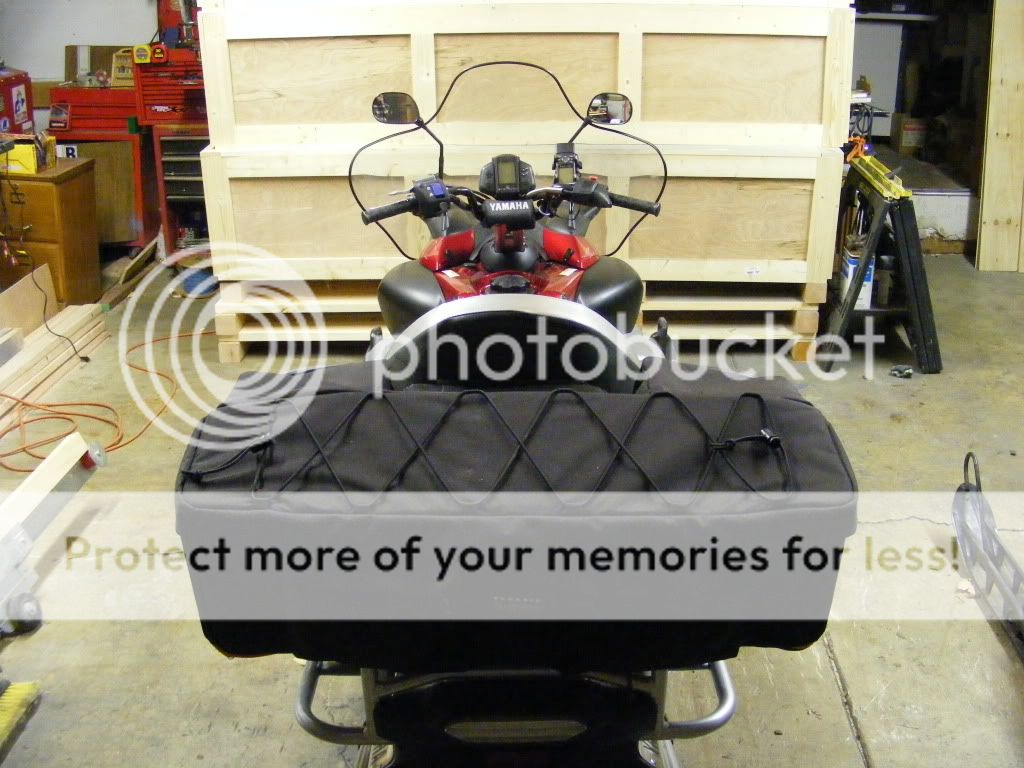

THE BAG ATTACHES 2 THE FRAME USING STRIPS N CLAMPS.....ITS KINDA HARD 2 TELL FROM THE PIX BUT U CAN STORE A TON OF STUFF IN THIS BAG......IT ALSO HAS A WEATHERPROOF COVER 4 IT 2 KEEP IT DRYER THAN USUAL. HOPE THIS CAN HELP SUM1 ELSE MAKE BETTER USE OF THE RACK.......OH YA THE TUNNEL IS ALSO STILL FUNCTIONAL 4 CARRYING SMALL GAS CANS. :bling :Rockon:
