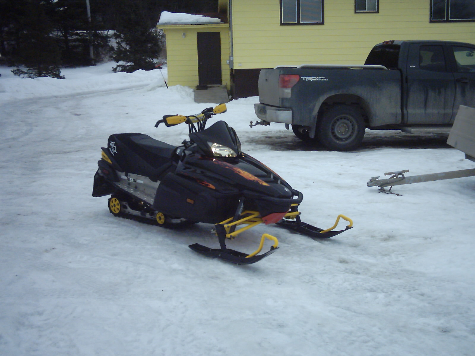

Here's my list:
SLP Powder Pro skis
Muffin Works a-arm protectors
Muffin Works 136 tunnel extension
Muffin Works custom billet 136 rails
Muffin Works 6" billet risers
Muffin Works tunnel supports
Ulmer clutch kit
Cobra track
ditched the Fox Floats for CYTR clicker front shocks
revalved rear shocks by Pioneer
I know it doesn't have any engine mods. But this is 100 times more sled than the stock version. I can go through more powder, and way rougher trails than in stock form.
