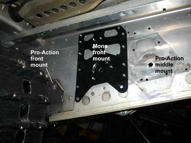

We are working on developing mounting plates that simplify mono installs into the o3-04 sleds. Our plates will locate themselves using 4 existing rivet holes and the center pro action hole. Once our plate is mounted it then serves as a template to drill the new mono front mount hole.

Is this instead of buying the Apex mounting plates? They already line up with some of the rivets so I just used them as a template and it was pretty painless, unless you are talking about a 136" and that's different than the 121"?
