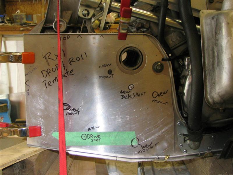

ThatSpec, I think on you question about the meaning of the "drop and roll"; the drop we all unserstand, the roll is to keep the bottom of the chain case from being in a precarious place for rocks etc and to keep the correct center to center on the clutches. I might be wrong but that is the understanding I have of the roll.
Rx1M5

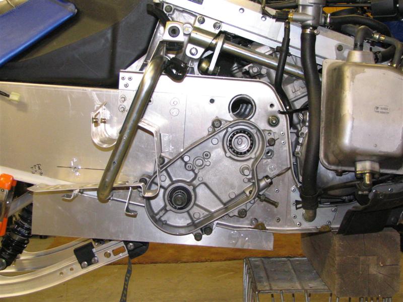

The drop is to create clearance under the tunnel between the track and tunnel. The roll is used to create clearance from the front cooler. The center to center distance is maintained by the jackshaft placement in relation to the crank where the drop and roll term really refers to the driveshaft. Check out the pics of how I did mine and maybe it'll make more sense.
Paul
Paul
Feetsbig
cool,did u make the template or buy it?
Rx1M5
I made it.

Sorry to drag this back up again but I forgot to say thanks for the reponses. Paul the pics are very informative, can't believe your clearance. One thing I don't understand is, how you were able to use a stock clutch belt after this. I guess looks are just deceiving in this case. Pretty cool though probably more than I want to tackle.
Mark
Mark
Rx1M5
The center to center distance from the crank to the jackshaft does not change just the position of the jackshaft in the chassis changes. The jackshaft "drops" and the the driveshaft drops and rolls back.
