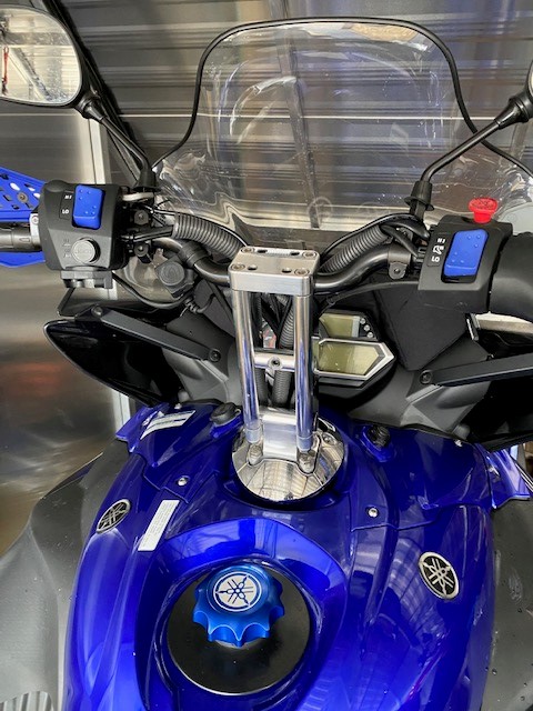

Put a +4 on my XTX from Superman, only had to put throttle cable under the bars as you can see in the picture.

Ya I rerouted the throttle cable under bars , I think the owner before me put the 6 inch riser on , well now I have the seven inch. lol
