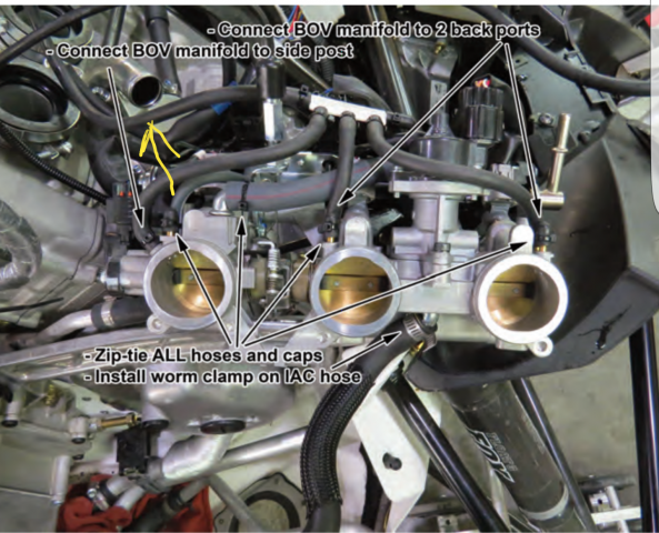

I think the hose you don't want to disturb is the one going to the GEMS. I cant post a pic but mine is connected into the cluster of small lines that go to the throttle bodies and blow off valve.

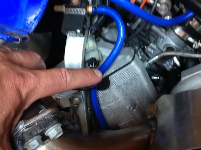

Thanks! This might be easier if I post pics and you guys guide me...I just want to be sure.

yes this is where I have mine tee'd in I am on a super charger I don't think that matters.This one?
OK...I just sent the pic to MPI to be sure thanks again!

perfect I think that is the same line I was talking about those are the nipples by the throttle bodies right?
