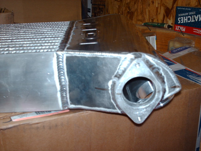

The IAC hoses Might need to be connected to the intercooler.
There is some debate about this with supercharger because of high pressure in intercooler at Idle without bypass, but with it I would connect them to the intercooler.
Ted.

srs8288 said:I am having the exact same problem. My fuel/air ration is all over the place and sled surges badly during transition from pressure to boost. Throttle body boots have blown off twice. I am going to permanently fix that issue tonight. So Ted, you think we need to attache the IAL directly to the Intercooler and that will solve the surging problem? I also, installed your BOV, can't compare without it because I installed when I put the supercharger on.[/list][/code]
Yes directly to the intercooler plenum.
I believe this will help alot.
Ted Jannetty said:srs8288 said:I am having the exact same problem. My fuel/air ration is all over the place and sled surges badly during transition from pressure to boost. Throttle body boots have blown off twice. I am going to permanently fix that issue tonight. So Ted, you think we need to attache the IAL directly to the Intercooler and that will solve the surging problem? I also, installed your BOV, can't compare without it because I installed when I put the supercharger on.[/list][/code]

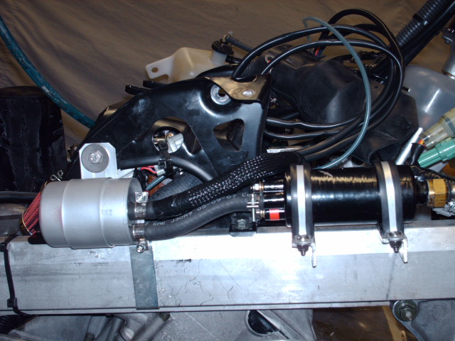

I'm thinking maybe a fuel pump issue as I got the MSD pump from ebay for $65 and it had no MSD sticker on it or in the box, only the pump. Maybe I got a factory second because they normal are $100. I have a 1/4" ID aluminum fuel line in the tank, 3/8" ID Goodyear hose supplying the pump, 5/16" ID Goodyear hose from the pump to an automotive fuel injection filter and then to the fuel rail. The pump is triggered off the stock fuel pump connector. I use the stock pump power supply to turn on a relay which powers the new MSD pump. I'm using #14 AWG wire for the pump. Maybe I should try the stock pump setup and see what happens. I 'm full up on gauges so a fuel pressure gauge is a no-go. I still have not checked anything closely yet because of my work schedule right now. I'm looking for directions to go.
Keep them coming guys!

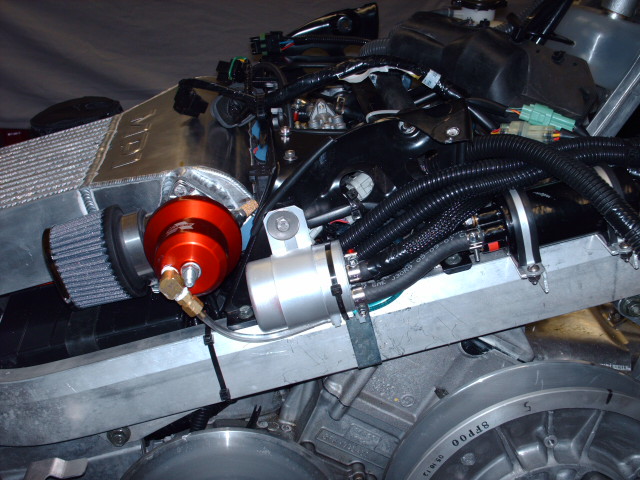

Take the filter off the bypass valve it is restricting flow.
Do not hook the fuel controller to vacuum it will blow the internal map sensor of the fuel controller.
Ted.
Ted.
