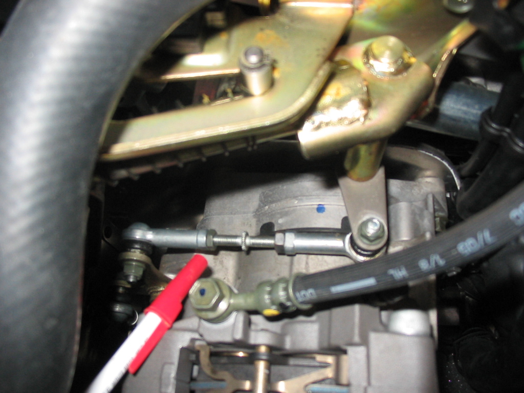

It can be adjusted. There are threaded arms on the linkage from the lever to chain chase

I had my reverse slot welded and remachined so the handle goes farther towards the tank without having to compromise the total forward engagement..works great..I found this by accident by holding the lever as far left as possible and noticed reverse worked great. When you release the lever in reverse, it actually moves the shift lever back towards forward a little. I had the slot moved so it stays pretty much as far 'left' as it can get.. Again, I was just concerned as adjusting the linkage takes from one to give to the other, and I want forward engaged as far as possible.
