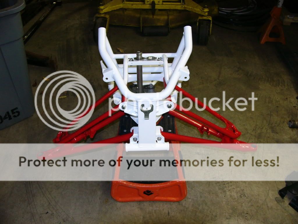

after thinking of selling the phazer this last spring/summer i have come around to keeping it. i wanted to start racing sleds since i can cross train with the motocross. but with no time to race i decided to tweak the sled a bunch. ill get pictures when its togeather, there are lots of parts missing right now LOL
08 fox floats
powder coated a arms red
powder coated rails/spindles black
red oe plastic
black seat cover
custom air box mod - hard as hell to keep the snow out!
clutch kit
dynojet commander with wideband- laptop tuning capabilities.
antiracheting drivers! - ratcheting got me mad.
in the makes- custom true dual exhaust with x pipe header. (bro is a welder/fab) going to see what happens... maybe to much flow.
working on--- 13.5 x 128" conversion offset extension for 8in wheels. going to try the new 1.7lug cat track hope it clears.....
i need to do something to the rear suspension.... thinking hygear.
i really what to turbo it. just cant see dropping the 4-5k on it yet... anyone want to sponsor me one? LOL
08 fox floats
red oe plastic
black seat cover
clutch kit

SkyHiFX114
i still have more getting powder coated, for the most part the front is done.:headbang

haha, maybe if u have some shocks that are 2in longer with cans (prox chassis walkers) i would trade. with out the sway bar i lost some spring rate. I had fox floats, but these i just got back, had them setup for snow cross, they are STIFF! but i would like little longer, little more travel.
