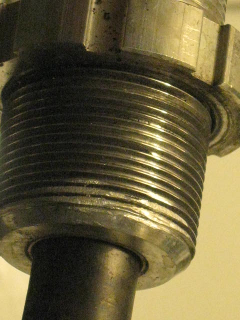

just broke mine today,and i was wondering the same thing,my sled is an 09 vector ltx with only 800 miles,wasnt to happy when i noticed it,funny thing is it happened loading it on my trailer it spun on the ramp and i heard a noise,it damaged the track a bit,this better be covered,my transfer was set at 3/4 transfer,i hope i can ride tomorrow without damaging anything else

How are all these transfer rods getting broke anyway? Do any of you have pics? Are the rods breaking or are the threads being ripped out? Also wonder if the locknut is tight and staying tight, or if its loosening up. Seems to be a rash of failures lately.

this is what mine looks like from this afternoon,i wasnt at max transfer,about 1/4 inch on the transfer gauge before max transfer,im guessing the lock nut must loosen by itself cuz if you look at the threads in the pic,only the last 3 threads are damaged

Sounds like they may be backing off and pulling the threads out then. Kind of hard to see into the rod cylinder in the pic 1654. I tighten mine with a chisel and hammer so it stays tight.

the first 3 threads in the sleeve are flattened,this better be covered on warranty,track and transfer rod,im going riding tomorrow but i'll take it easy,dont want to screw it up more,when i get the new rod i'll thighten it good and i wont mess with it anymore,

Mine looks just like PAT THE RATs..
THe thing loosens up and comes apart then gets jamed and bends..
I was told by a dealer this was an issue on 2006 models.. Im not sure why..
