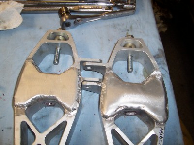

My understanding is the spindles bend when impacted from the side. Mine are fine, nothing bent so far but it looks like the 09's will be machined aluminum rather than cast.
:D
I ended up plating mine kind of like that, and it is working, but I was concerned with snow packing in around the ball joint.
