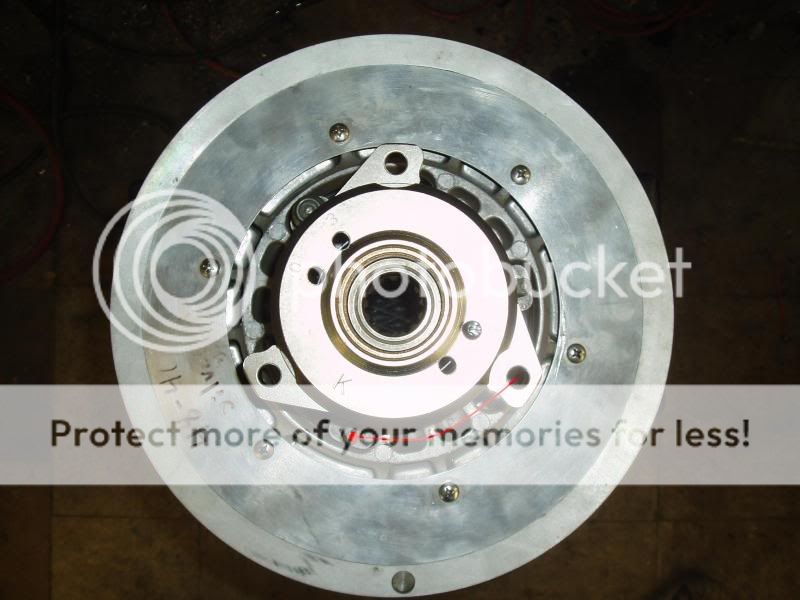

I am installing Ulmers Stage 1 kit on my Nytro. I am installing the new spring and helix in the secondary, it says 3-6 spring wrap. What does that mean? There are numbers on the helix, but none on the spring holes on the secondary. How do I set the spring?? Thanks! Frank.

The numbers go 1,2,3 in a counter clockwise direction! The stock spring was in the #2 spot. If you can see where that is it will give you a reference.
It should be like this to wind it. Wind it clockwise rotation to the next set of posts.
