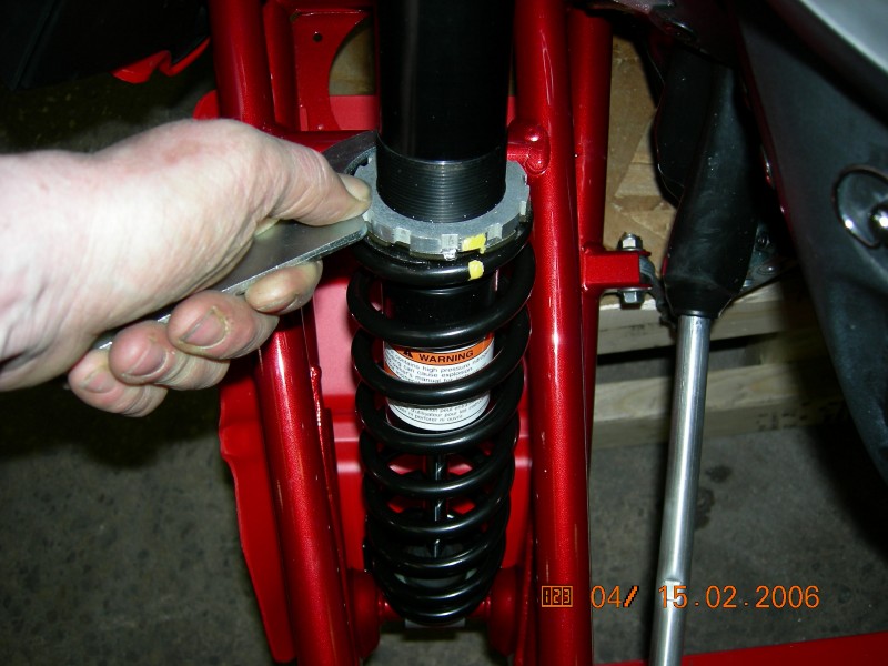

Mine have ZERO Darting, you just keep making small adjustments and YOU WILL get it
Even My Simmons Darted, till shimed and adjusted..........it can be frustrating but you got to keep at it.............Worth it in the end.
