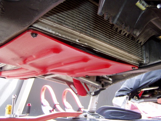

And that folks is why I run the $100 skid plate. I hit a rock hard enough to bend the front of my slide rails to the right 1" but didn't suffer near that kind of damage. That black access plate gives too much allowing rocks and other misc crap to catch the front exchanger if you land on it.

I'm not sure how strong the alluminum piece is that the front heat exchanger is mounted to but, it might also be wise to check the bulk head for any signs of cracking. It could be possible the bulk head suffered some damage also but, who knows maybe Yamaha designed that alluminum piece to be a weak spot.

Well I just went out and snapped a photo of my sled's underside for a comparison. Here is what mine looks like. Notice you can't see any damage to the plastic skid plate but yet there is still a small dent right were yours is severely bent.
Like I said I hit violently enough to know I hit a rock. If you did that kind of damge without really noticing anything; the skid plate would have definately saved you this headache.
