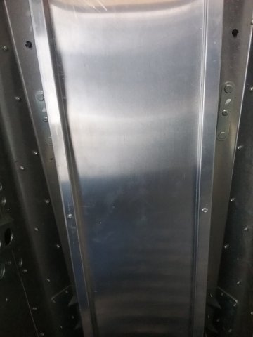

What's up? It prevents the snow of building up underneath ur tunnel. Otherwise the snow will pile up and none would get to the heat exchanger and would overheat. I over heated once got the plate and never again. Its riveted in. A few companies make them it's been a few yrs now I forgot what company. But just search nytro threads or Google tunnel block off plate nytro it will show.(old forge ny-Saint Alexis qc)Hi guys, I also have the same sled bought it at beginning of march. And was wondering what to add on aswell.

GreatLike this ,I had a buddy bend it up, I text him the measurement, and he had it tooo me after work .![]()

Thats cool. now I'm guessing this keeps all the snow off the exhaust system?

It does keep the snow off the exhaust but still allows lots of air up there to cool the pipes. It's a good mod that's really cheap. Stops a lot of the ice buildup that occurs in the tunnel. 1or 2 pounds if aluminum saves you from carrying 20-30 pounds of ice.
