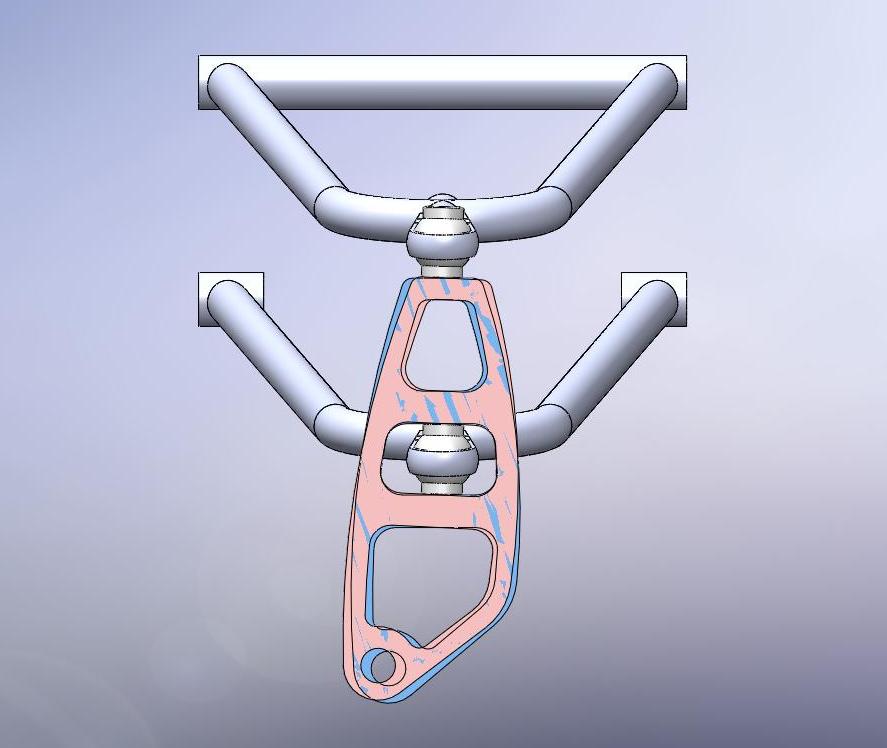

In doing this layout I think you may have a problem with binding if the line through the axis (mounting holes) of the two ball joints are not well aligned. I would recommend that you have your shop show you other sleds where they've done this mod. I didn't spend too much time on this but it looks a little iffy to me.
If it works, what you're changing is the trail of the spindle - although there are varying definitions on this term. You can see in the model below that the ski mounting hole has shifted between the blue and red spindles when I moved the top mounting hole 5mm. I created these models with a number of simplifications but the main idea is represented - I think.

arteeex said:In doing this layout I think you may have a problem with binding if the line through the axis (mounting holes) of the two ball joints are not well aligned. I would recommend that you have your shop show you other sleds where they've done this mod. I didn't spend too much time on this but it looks a little iffy to me.
Nicely Done!!!! That pretty much says it all.

I would love to hear some input from someone that actually did this, maybe I will ask him to give me a reference (b4 I decide to do this) and see what they thought....will keep you posted...if it does work it may be an alternative to the ball joint mod. Wish I bought the spindles I saw cheap on ebay a month ago.
