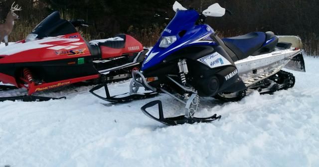

Made a thread a few weeks back , debating between the Nytro and Apex, seen HERE and decided to go with the nytro.. If nothing else, for the fact of a full warranty until Nov 2016.
Its a 2011 XTX , 7500 miles, dupont slides, shocks rebuilt last year, cover, 2 windshields, couple belts, saddle bag, dash bag, dual runners, and in really good condition.. Within the next few weeks or so, I will have it gone through at Hauck powersports, have the clutches gone thru and end up putting a cluth kit in, as well as changing plugs, driveshaft bearings, exhaust donuts, etc to get it up to par, so I can start from scratch on all my maintenance..
SO , Im sure I'll have questions about "must have " mods/parts.. Other than the clutch kit, and maintenance, I will get a skid plate, and possibly a OFT relocate, as I hear its a very good alternative to stock.. ANy other comments or suggestions, Im all ears, and its good to FINALLY have a newer sled, thats not carb'd haha
