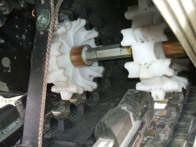

I attached some pics of the new goodies for this year, pilot 6.9 skis, a zr900 sno pro 1.375 track and some ski doo extroverts. Hoping to improve my off trail abilities a bit, just waiting for snow

Well I got to go for a ride tonight, we got around 8 inches of snow thursday. I am very pleased with this setup. Its nice to nail the sled from a dead stop with transfer set to max and not hear the track ratchet. This track hooks up like crazy. Hardpack trail its nuts and when you pull off in the soft stuff I can stand it straight up like nothing. They dont call it a quiet track for nothing........no howling anymore.

what tool's do use to remove and install xtrverts ?

snoman said:what tool's do use to remove and install xtrverts ?
you need a shop press to press them on and off the shaft. I am trying to get the measurements for them, I am going to see the guy whose shop I used to install them tommorow so I am going to get the measuremnts from him.

Very little darting, mainly at slow speeds. We got some rain too so the snow is very crusty. There alot better than the stockers for sure. I really like the way they work off trail in the crust. I found the stock skis to be tippy when they broke through the crust.
