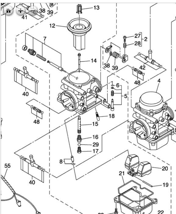

Does my 07 RS Rage GT have a pilot screw or an adjustment screw on it other than the ones for the throttle blades? I was going back through the pictures I took of the carbs and couldn't find any. There is one in the parts diagram, but it doesn't really show where it goes...
I didn't take it out if there is one, but I'm assuming its probably capped. Some of the other forum posts suggest that it might be..
Should be item #5. Is it actually behind the throttle butterfly?

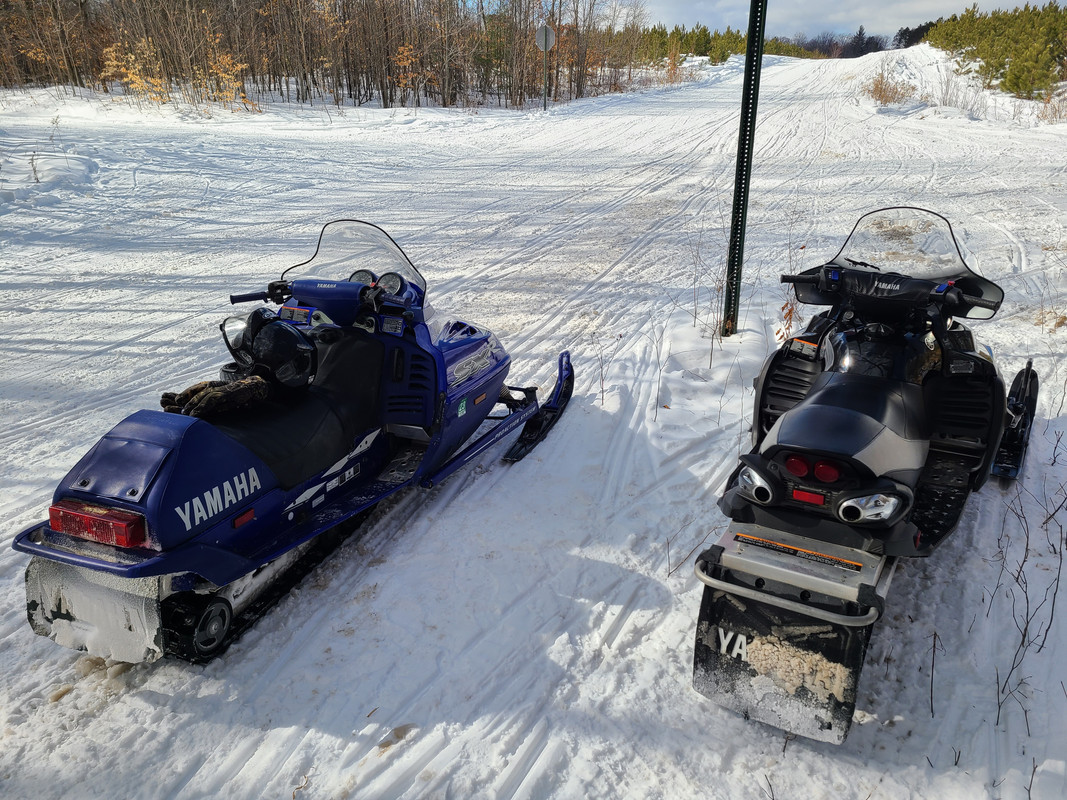

More updates on the sled. Ended up riding it I think twice last season (2020), and twice so far this season (2021). I only put around 200 miles on last season, but so far between the last two weekends I've gone 500 miles. So I am getting close to 2800 miles on the sled. Hoping to get one more weekend in before the end of the season.
A couple things. I was running wide open on the lake, and it started missing, and slowing down. I let off of the gas, and it just shut off. Uh oh. Started right back up though, and has been fine. Rode it another 15o miles without issue. Now I was running 87 octane, but I topped off with 93, and put some seafoam in it, and it has been perfectly fine since. Will keep an eye on it I guess. I never did change the timing chain tensioner so hopefully that doesn't bite me. The shocks Cannondale, refreshed for me are still working great. I also blew up my drive belt last season, but a new OE Yamaha belt seems to have been the ticket. No issues with the new belt. All in all, the sled seems to be doing pretty good.
My dad had a 2000 Polaris 550 fan, that blew up on the trail, so I towed him back the remaining 5 miles. But at the last second, I converted him over to Yamaha, and he now owns a 2000 SXR 700. 3800 miles on it at the moment, we changed the slides on it, and it ran the 250 miles this weekend no problem. Finally a sled that works decent for him.. (knock on wood).
Hope everyone has had good luck so far this season!
