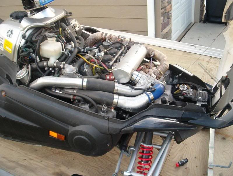

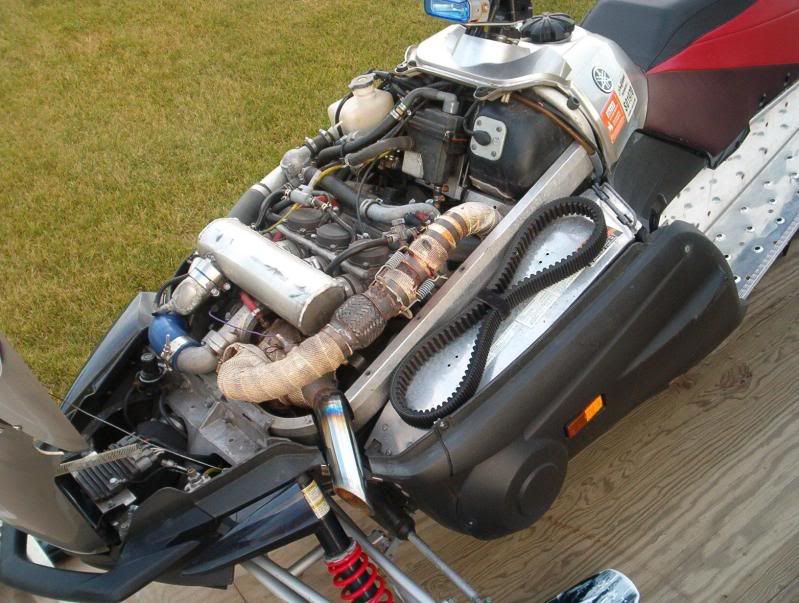

Here is a couple pictures of the sled I just bought and a couple pictures of my past projects.
Picture of the vector
Old Picture I found of the yamaha From before the guy put the snow to air intercooler and before it was finished.
Pictures of current setup
