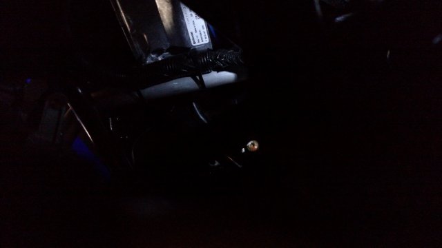

Best pic I could get. Cant see cat label.

I can confirm it is a cat ECU. It is aluminum, and has a arctic cat label. It also has "continental" and synnerject" written on it.
Thanks for checking! I agree the Mitshubishi would have been nice to find but it is just a ecu. It's the programming that counts most.
Same #*$&@ made by continental
Hardware from Continental is not the problem. It's the programming of the software. My dealer said that people from Yamaha are involved in the new flash. The -17 Viper have already the new flash so we hope it work....
