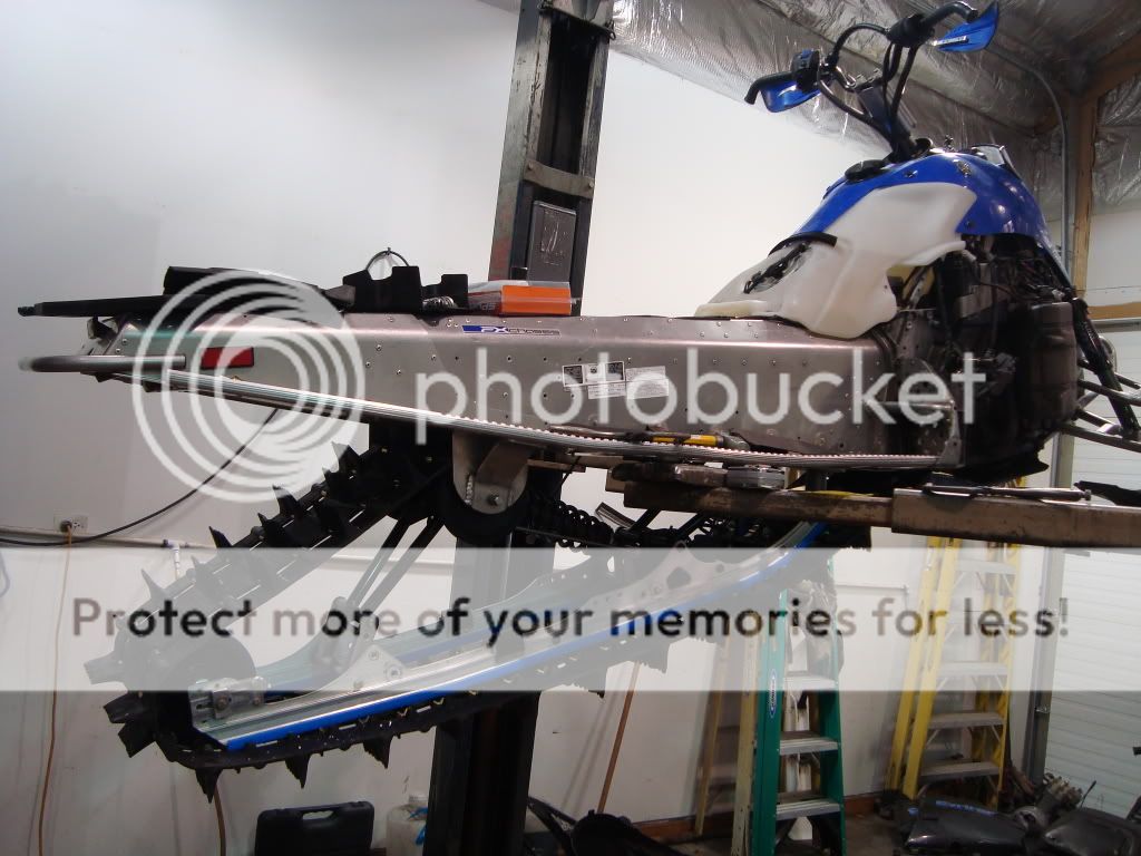

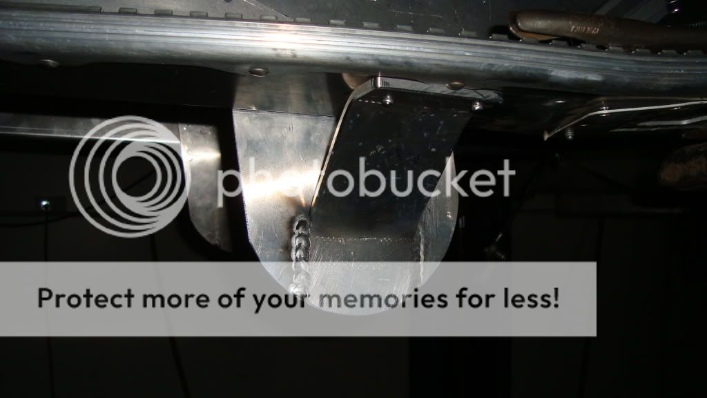

I started putting the track in this weekend got it hung from the drivers put on the 162 had to move the mounting holes back to move the skid back enough for the longer track plus it gives a lot better approach angle. I also had to fab up some aluminum drop brackets which I figure offset the added weight so still 45 lbs lighter than stock. I chose to delete the reverse to shed some weight and get rid of the extra rotating weight, and I am getting 19-42 gearing with 3 in pitch 7 tooth Avid drivers. So about a 2.49:1 in 9 tooth equivalent numbers. The suspension is only temporarily mounted in this pic I have to take it back out to finish installing the drop brackets and remove more rivets in the tunnel up by the chaincase so the track wont rub and destroy itself.

Looking good. Need to taper those running boards back and trim down the tunnel extension, it makes a big difference in deep snow.

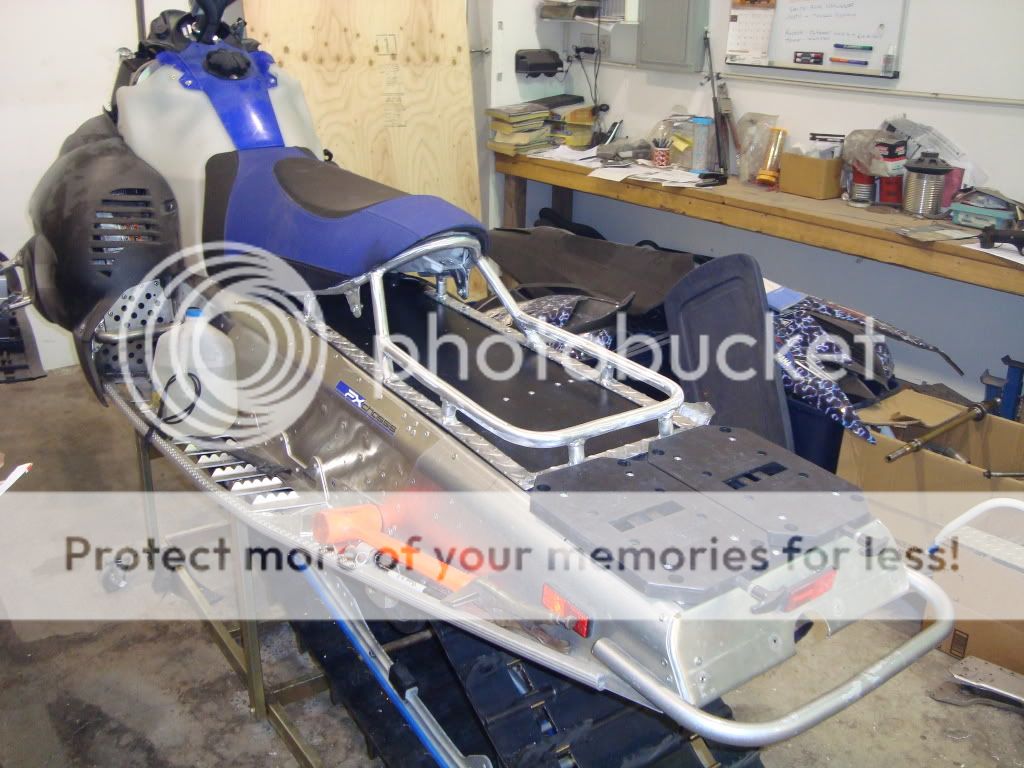

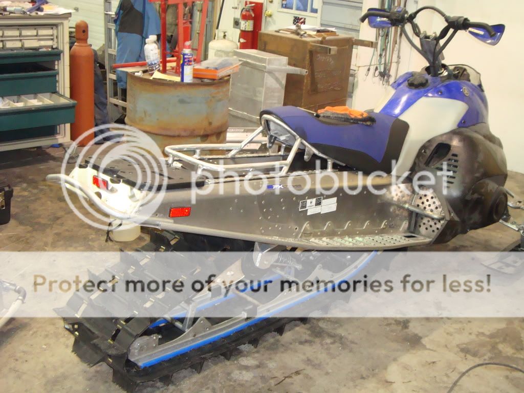

I went up to the valley and got my suspension mounted in and built a rack and installed the QRS Gas Can Mounts. Got the chaincase put back together with the 19-42 gearing. Everything came together nicely!! Test rode it in the yard and the 162 seemed to hook up awesome but there really was no snow to test in but about 4 inches, I was going to test out in Turnagain Pass but it was late at night and the fresh snow was all tracked up so we decided to test it out another weekend. Here are some pics.

love the seat brakcet/rack!!!

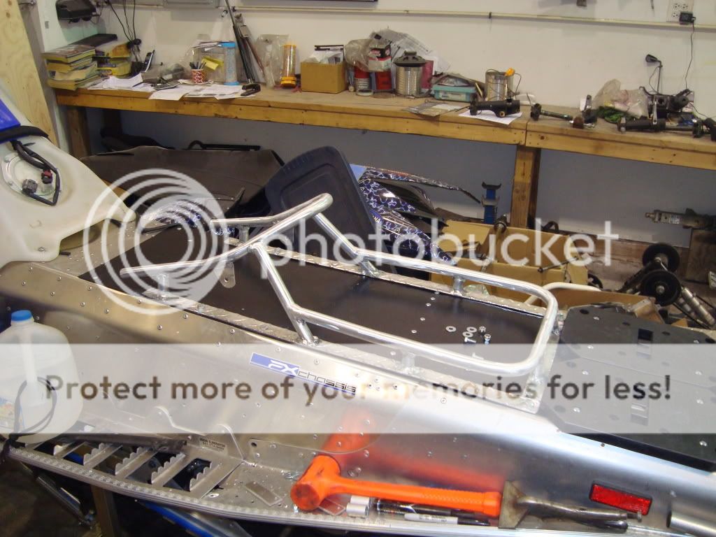

If anyone is interested in one of the seat bracket/ rack that has under tunnel exhausts PM me. Or if interest in another style rack let me know. Later, Justin

That looks great!

Nice exhaust set up! I did a under the tunnel with a cherry bomb type muffler and inserted a silencer. Did this on a 08' & 09'. Loudness is down to 88 db range had it tested. My pipe does not extend out the rear and my tunnel traps lots of snow. If I extend it out the back like your system will it reduce the snow build up under the tunnel. Please let me know.
