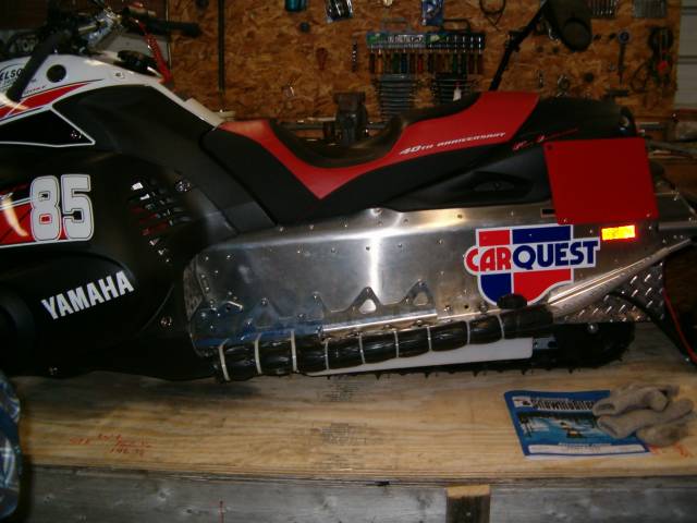

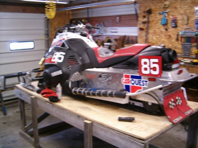

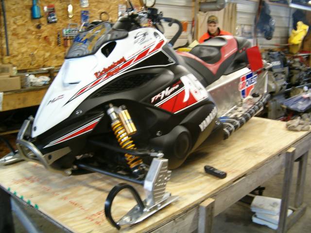

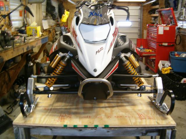

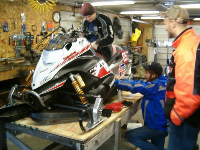

Here is some pictures before they left. They might be a little fuzzy from the camera.

Ya – I only meant chassis mods. I bet the stock setup only gets about 50HP to the track so lots of room there. Do you use both Yamaha clutches?
So…did you switch shocks to Ohlins as they were shorter for your application? Oval sled shock settings are crucial – so just wondering why you changed. If your track selection and suspension are not top secret - can you tell me which ones you used? I’m surprised you went to a shorter track.

Yes, he uses stock yamaha clutches. The Ohlins have stiffer springs than the GYT, but he still uses the long shocks. He shortens the spindles to get it lower. It is just a Wahl 116in. suspension and a low profile race track. This will be the 2nd year for the Phazer at ER. Last year Kris ran 1 heat race, and a Final with the 4stroke Phazer. But after he figered out how to run the Phazer on the track, the race was over, and ended up with 3rd. The Phazer was stock too, no clutch work, stock gearing, just lowered with a Wahl 121in. suspension. Now in M.I.R.A., he Won a final at Drummond Island MI., and ended up Winning the Smi-Pro 500cc class Championship for the year. BUT had to forfit the win because the Phazer wasan't classified to race in Oval Racing, but this year it is.RJH said:PureBlue
