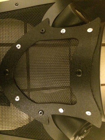

I just built a custom console vent to help getting air flow to the radiator to help prevent the sled from over heating etc. Let me know if interested. Thanks.

How much?I just built a custom console vent to help getting air flow to the radiator to help prevent the sled from over heating etc. Let me know if interested. Thanks. View attachment 100902

Heat exchanger helped me out greatly. I was getting the temp light all the time, now with the heat exchanger in I pretty much never get it. I also have water wetter mixed in as well to help some more too.
