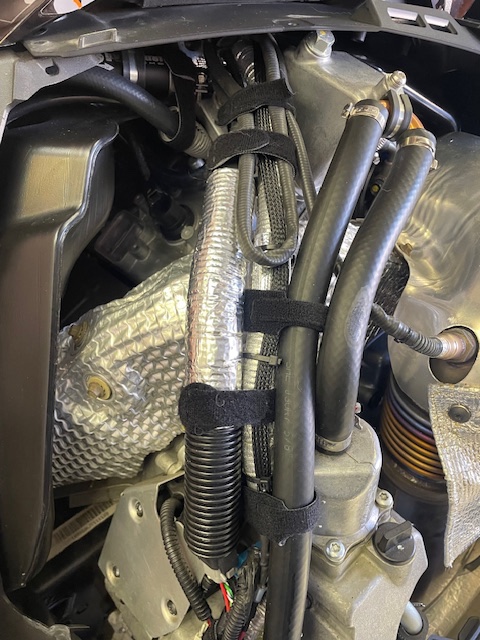

Yeah they give you a boatload of wire with the AFR Module. Not only that the location of the plug is down by the chaincase in an already cluttered area. I just pulled the feed back and cut it at the steering post and spliced into the AFR Module there. It's very simple to do, only 4 wires, power and Canbus. Did the same for the communicator and it really cleaned things up.I’d like the shorten the lead on mine as it’s way longer than I need. I’d like to get my hands on the pins used in the plug so I can shorten it and re pin the plug as opposed to cutting the wire and splicing

put my module along the harnessYeah they give you a boatload of wire with the AFR Module. Not only that the location of the plug is down by the chaincase in an already cluttered area. I just pulled the feed back and cut it at the steering post and spliced into the AFR Module there. It's very simple to do, only 4 wires, power and Canbus. Did the same for the communicator and it really cleaned things up.View attachment 178349
