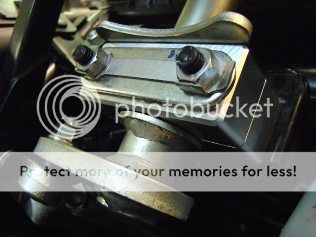

Moto left out one point in his answer. Look at this picture:
There would be interference between the steering stop "wings" and the steel bar that bolts on over the studs if the studs were not bent down like we require. That means no spinny-spin of the steering post and for those of you who like to turn.....well, I call bending the studs the "lesser of two evils" in that situation.
