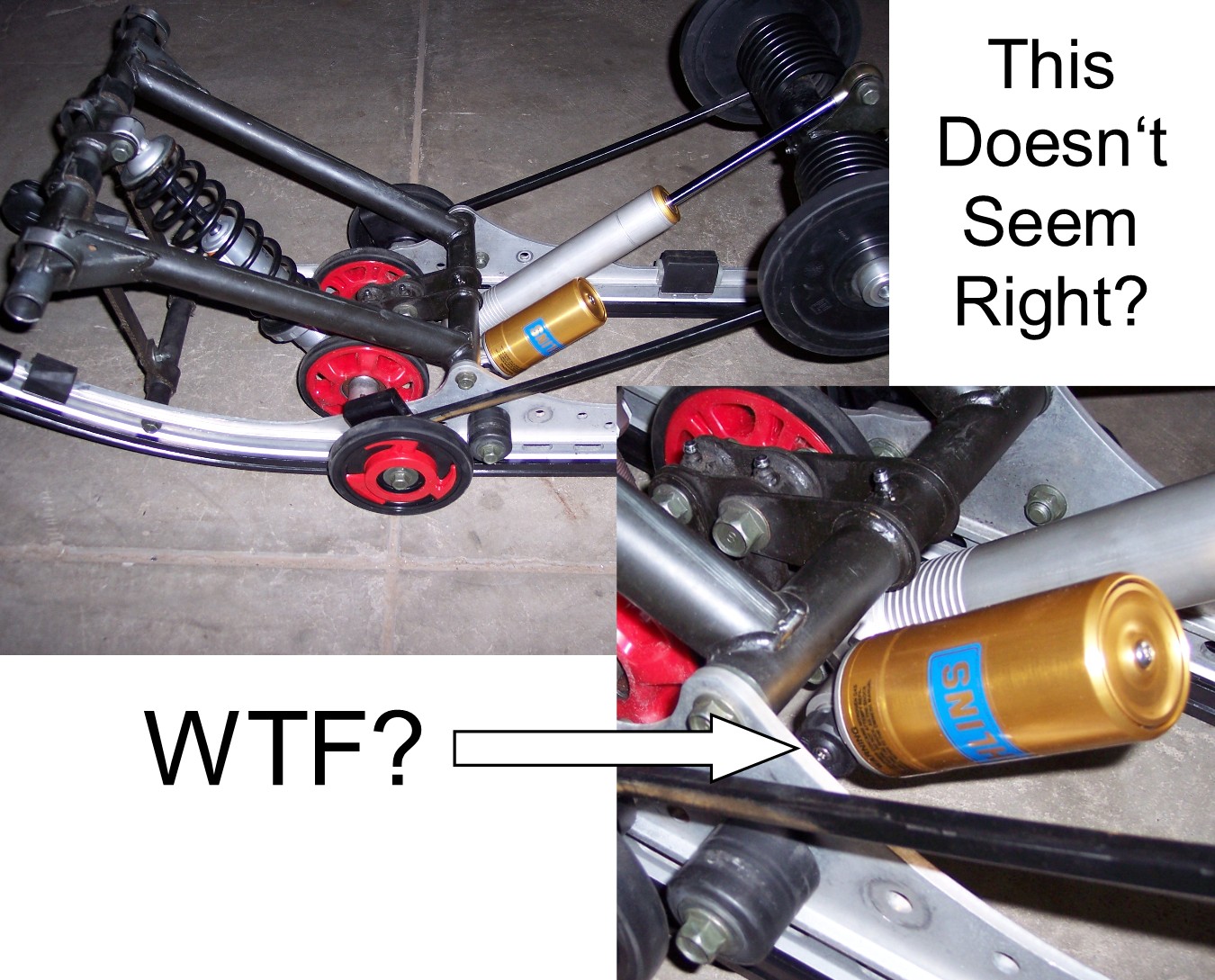

yammie3687 said:Is the ohlin rear shock for a 05 rs vector that is available thru yamaha adjustable? Can you adjust the compression on it?
I have the Ohlin and it does have a 20 step clicker for compression dampening. It's an awesome shock and will solve all your excessive reounding problems on the 05 Vector. I will admit, however, that the cliker knob is in a very inconvenient location. Last year a few of us TY members were discussing different knob solutions, but in the end, you just have to find a way to manuever your finger tips onto the know and still have enough room to turn it.
See the attached picture. When I origignally installed this shock, my thoughts were, "WTF? I must've installed the shock wrong!" Nothing's perfect, I guess.
Good luck,
Greg
