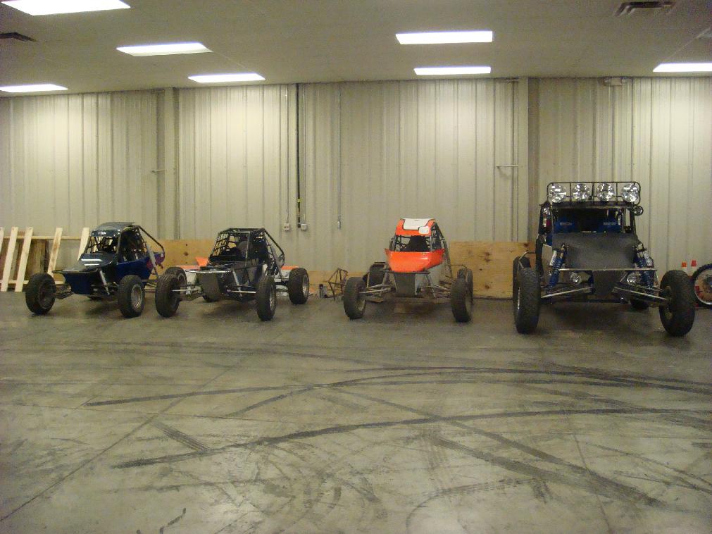

I'd be playing on a sled if we had snow in Cincinnati, but I'm stuck in the dirt... (which is fine - dirt runs through my veins - see pic below - three Stadium Lites and a Class 10 desert race car)
No chance that you could put a three cylinder power plant in one. There's really no need for the extra hp the triple would make - the Phazer powerplant's on the verge of being too much for the tires to keep traction on anything other than sand.
