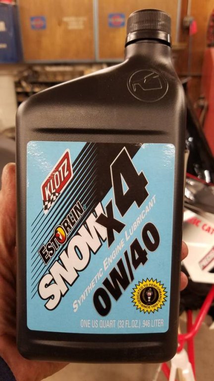

Early in my sled's life, I had what I considered lower than normal oil pressure, especially when oil was cold (I was using 0W-40 Klotz Snow Estorlin at the time). I pulled my oil tank apart to find that lower suction screen clogged with very thick "goo" almost like heavy 5th wheel grease. It was from the oil!! I cut open a couple brand new bottles of that Klotz and they all had some kind of heavy white goo in the bottom of them, same stuff that was clogging up that suction screen! I have never used ANY Klotz product since. (When I called them they said it wasn't right but it wouldn't hurt anything!).
See pics.
