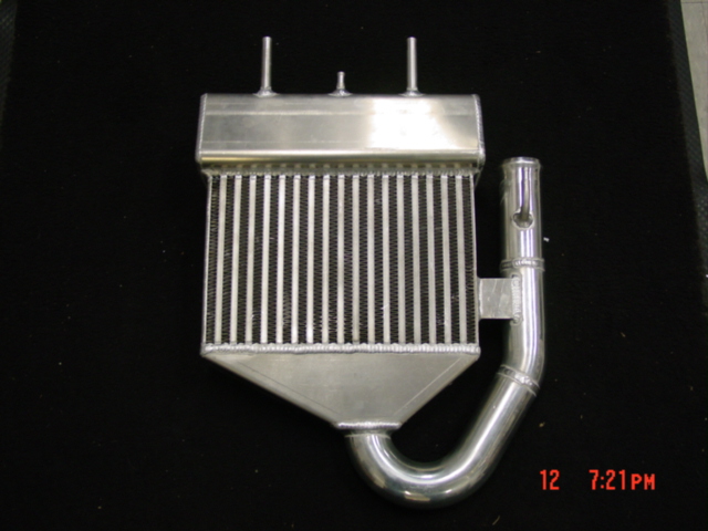

sledfvr said:I've been thinking of getting rid of my old bender rear mount gt2860 kit. I found an older cpr kit for a pretty good price. I am wondering about the efficiency of the older style cpr intercooler? It looks pretty small. My bender kit has a tunnel cooler and a decent sized ic. I ride mountains only with back to back pulls and don't want to heat soak too bad. If I went with the cpr kit It would definitely spool faster and I would get a mesh hood for more airflow. I would probably get a different header for it too. I'm curious how many pounds of boost the old cpr ic's are good for?
Efficiency of the intercooler, Count the 90 degree turns the air has to make 4 comes to mind.
Not only that but all the air is loaded in one side of the carburator tank.
Someone who will remain nameless recently had an air filter fall off during a grass race and injested a bunch of dirt so engine disassembly was necessary the cylinder closest to the air inlet on the carb tank was loaded with dirt where the other three only had a small amount of dirt so this confirms our suspicions about which carb gets the most air.
This intercooler design is the one that makes the most sense.

Thanks for all the info. My bender i/c looks almost identical to the one Ted shows...only the inlet tube is on the other side. My i/c has never even been hot to the touch with my bender kit. I think the snow cooler does a lot of good. I don't know if any air i/c is very efficient with the poor angle they are on and all the battery crap behind them restricting airflow. Then factor in the sled being straight up and down all day climbing hills and there is probably little to no air flowing through the i/c.
I am not sure which direction I'm going to go here. I'd like quicker spool up, but I not sure I want to deal with all of the heat up front or getting rid of my snow cooler. I really like the design of Impulse i/c and header setup, but it is spendy. Thanks for all the info.

What Ted says, that's the only way to eliminate sharp corners and 90 deg changes in the air flow. The one in the pic is the most efficient with the best cooling, most even filling of the carbs and the least pressure drop over the IC.
