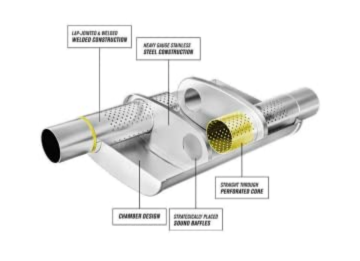

Interior pic of my muffler. I just find it so hard to believe that this design cannot flow enough?!?!

Not good, very restrictive, i can almost say that is your problem, my offer still stands.Interior pic of my muffler. I just find it so hard to believe that this design cannot flow enough?!?! View attachment 171352

Not enough flow.Interior pic of my muffler. I just find it so hard to believe that this design cannot flow enough?!?! View attachment 171352
If you have a guy making you a muffler, make a straight through design. Every time that exhaust has to make a turn, it's a restriction.
Cut that muffler off and weld a bullet type on there to test. Should be cheap, quick and easy. That will tell you if you have a flow problem.

We built a pair of mufflers with magnaflow xl bodies, looks like same muffler design. They ran good for us, but eventually got loud.
I was running 74 grams, qay70s, stock springs & helix, 9050rpm on powertrail, 3bar sensor, no cold air

quit sugar coating things and tell me how you really feel? Lol.Not good, very restrictive, i can almost say that is your problem, my offer still stands.
yes, please give me a day to think things thru and consider. Ty, jonYour welcome to try the 2.5 Turboforce I have also
Understand your direction. yes, this can be corrected.Not enough flow.
My guy works ummm at a very methodical pace. Job like this will definitely take a few weeks. Better to approach him in the off-season.
