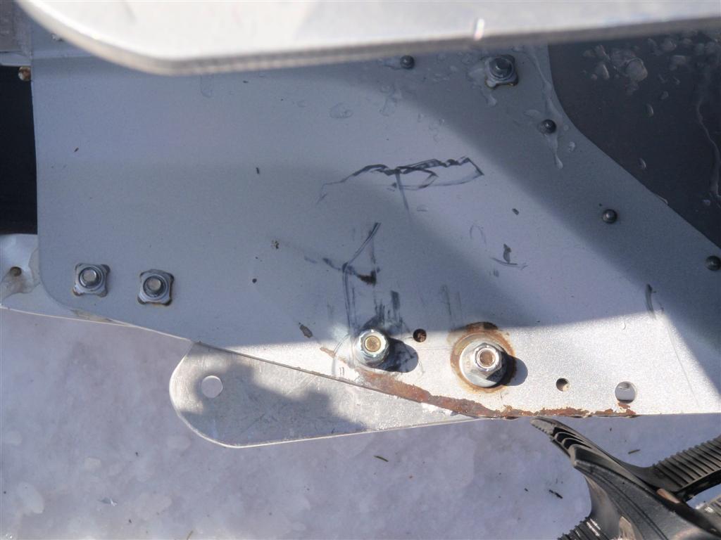

What kind of rear brackets are you guys using on the 151 setbacks?
Anybody got any pics?
Brackets
I used 1/4 inch aluminum plate
Genesis80fi
Thanks!
TreewellDweller
Rear Suspension Brackets
http://www.ty4stroke.com/viewtopic.php?t=80160
This is the thread with the brackets that I made with some steel plate. Hope the link works. Very similar to the aluminum plates on the previous post. Just an idea.
Good luck! You won't regret it!
boondoggle
I basically tried to copy tbyrd and treewell's brackets. Used 0.25" aluminum I found in the junkyard. I have yet to ride it. I posted on my experience with the mod. Here's the link.
http://www.ty4stroke.com/viewtopic.php?t=88677
