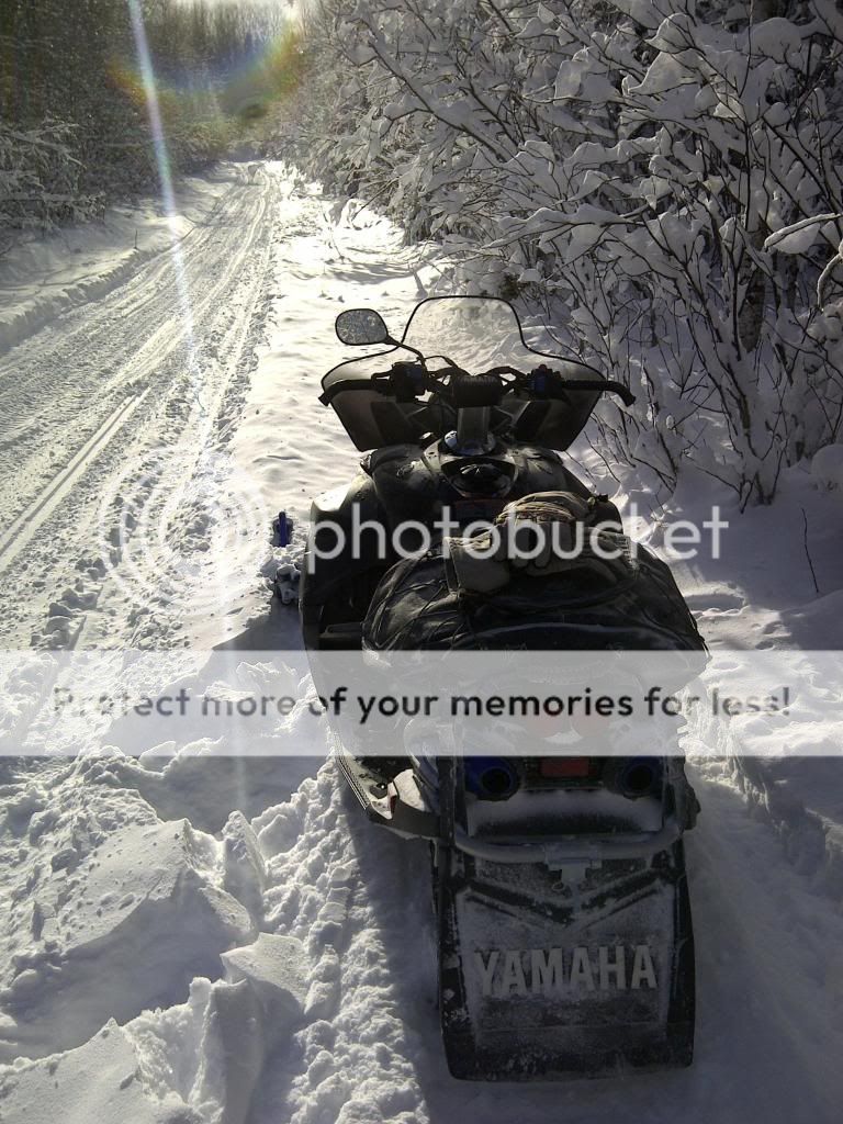

Canadian Tire has a universal hitch part number 26-9403 that wraps around and bolts to the rear bumper/ grab bar.
I put one on my Vector and had to open up the "C" mount plate so it would fit the 25mm bar. I used a 3/4" pipe (1.050" dia) and formed the mount bracket over it like on an anvil. I then squeezed the "C" plate back together to the right size. The bumper has to be drilled for 1/4" bolts.
If you zoom in, you can see it mounted on the Vector below. I bought one for the Phazer but will have to grind off the reflector first, see pic.
If your ice shack is big enough, you will probably want to invest in the proper Yamaha hitch as it ties back into the tunnel.

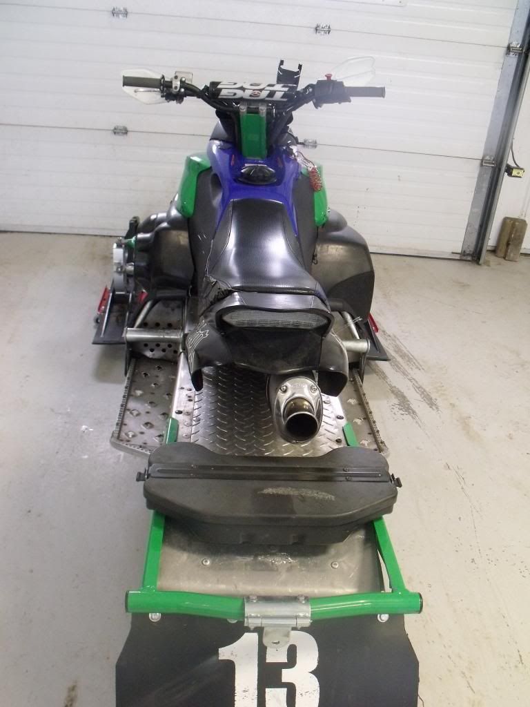

dwh039 said:Here is what it looks like installed.
Best option .... have homemade version similar to the Kimpex version ... spreads out the load more .... phazer has no trouble hauling
