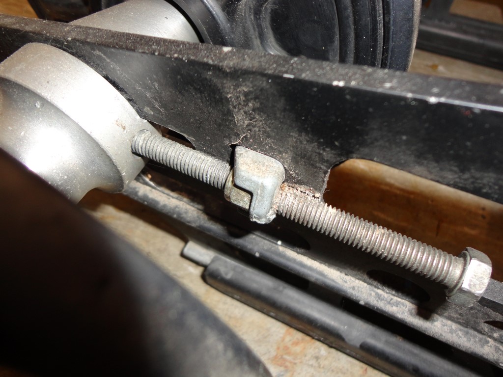

steve is that bolt going thru any stock parts from Yamaha? And is that hole you have that adjuster mounted in,same hole in sidewinder skid?Wont break this! And I run my track tighter than spec.
The adjuster bolt still goes through the stock part the nut is against but its flipped to the outside. Hole is same in Sidewinder skid.steve is that bolt going thru any stock parts from Yamaha? And is that hole you have that adjuster mounted in,same hole in sidewinder skid?

So the push point is now the nut on inside of adjuster,as the adjuster becomes just a stationary point of ref. and the hub that mounts wheel,is now your push point,cool. Ya very pricy,may need that,and have to wait on my side panel another year,siense I may not ride much this year from my newest heart bypass surgery!Wont break this! And I run my track tighter than spec.
