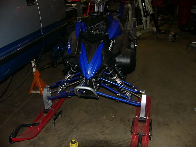

SkyHiFX114
i have C&A pro's and also fliped the spacers in the pivot of the ski on the spindle offsets about 1/2in which made all in all its about 2in-3in wider. i forgot if its ski to ski 43.5in unsprung or 44.5in. ill check when i get home. but i think that made a huge difference on handling in the corners. also i run a 10in carbide.

SkyHiFX114
heres a pic of mine with the C&A pros crappy pic but u get the idea
