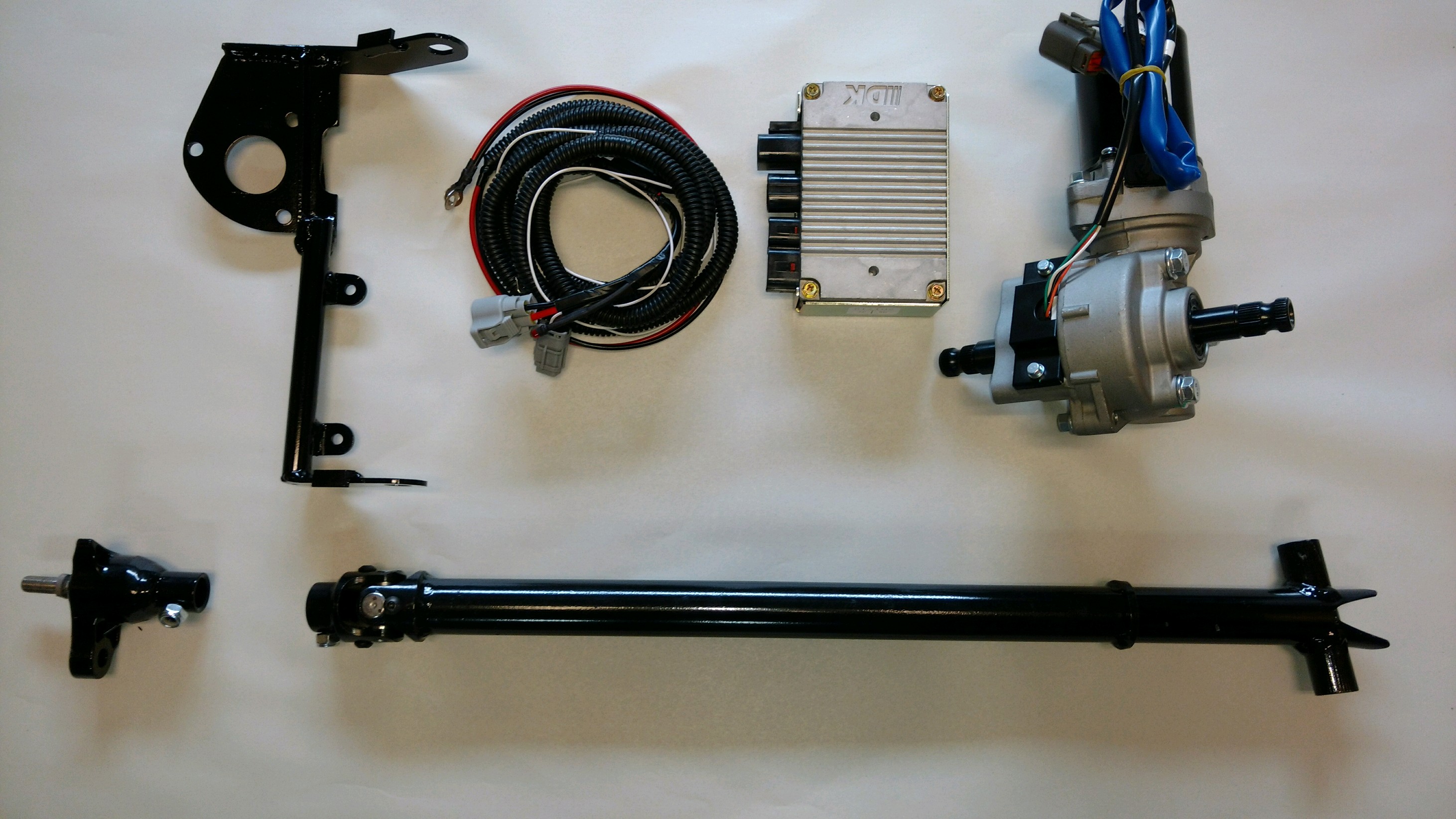

I just installed a GSE power steering kit on a 2018 Sidewinder XTX. Easy install, great fit. Seems to work well on cement/grass/gravel. No chance to actually ride it. Appears well made/engineered. You would never know it was an add on by the look of it.

Yes, I too would like to hear feedback from anyone who has used the Power Steering kit from gseperformance.Has anyone pit one on a sidewinder and if so does it make a difference and who sells the kits ,thanks
Looks like a great idea for those high mileage days, and its from a TY4 vendor!

I have a 20 tcat ordered and have the gse power steering kit in my garage for fall install
Review to follow likely January
