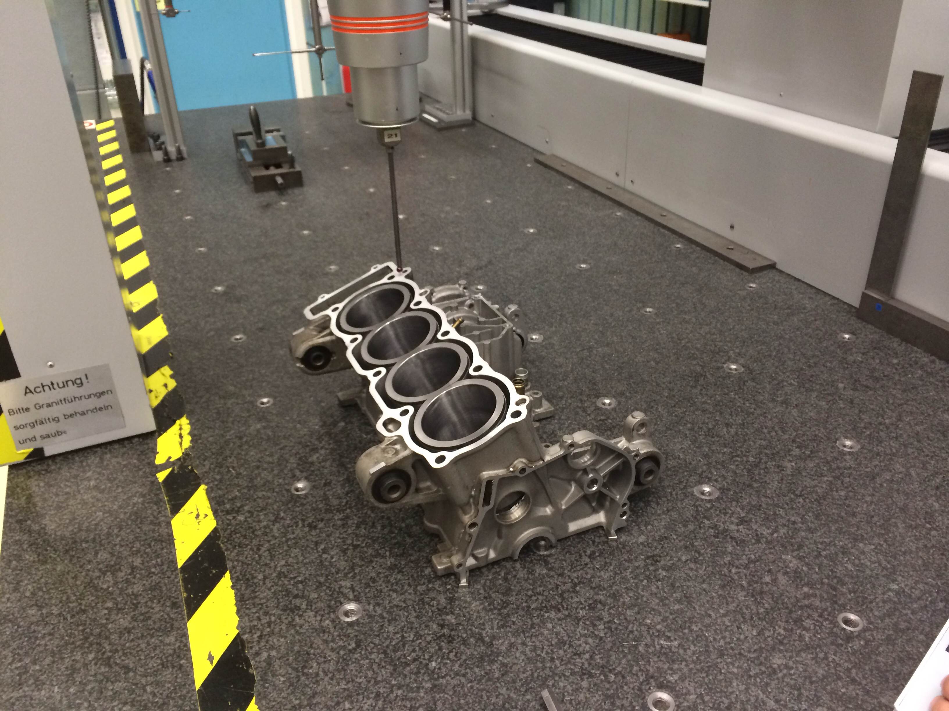

Yes i did. But clearly they did'nt have the block assembled when working on it. I noticed some minor marks on the surface on the upper half, but the marks wasnt on the bottom half. If something has been squeezed in between the marks should been on both planes. Im pretty sure that the upper half have been placed alone in the hydraulic press when installing the sleeves, causing the block half to bend. I have measured all 3 planes in a calibrated Carl Zeiss measure machine at work. The upper plane ( cylinder head plane on block ) has a total max/min difference of 0.068mm. The lower half plane on block ( Yamaha original ) total diff 0.017mm and the lower plane on upper half of block ( after the sleeves was installed ) total diff of 0.226mm. No wonder the crank would'nt spin, or even fit.. I have sent the block to the company again and they say they will fix the problem. Im curious how!

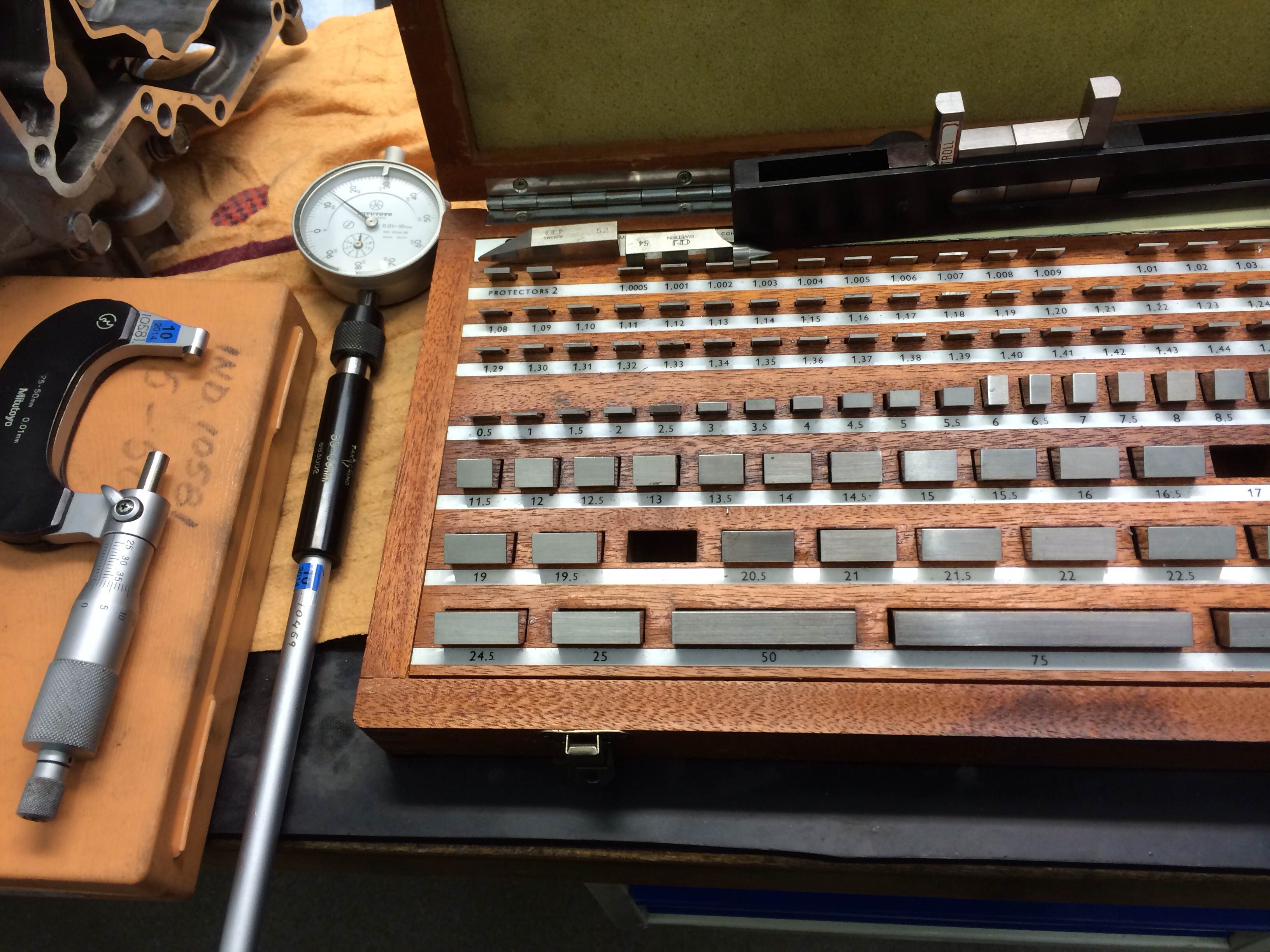

No the main bores has an ovality of,, im not lying 0.23mm. I calibrated and zeroed the gauge at 37mm. You will se by the pictures that the mains is way off. This is after i got the block back the second time ( after they align honed it ). Measured in 45deg intervals around through the whole block, they where all about the same.
Still they say it will run. I say it will probably run for seconds or maybe minutes before it breaks down. Funny thing is the responce i get after sending them the reports from our Carl Zeiss measure machine, all my other measures, and pictures of how bad it is they seem to not care at all. Looks like they want me to buy another engine and throw this pile of junk i just wasted $2300 on in the garbage.
The Carls zeiss reported theese numbers
Flatness top half of block ( cylinder head side ) 0.066mm
Flatness bottom half of block ( main bearing side ) 0.017mm
Flatness top half of block ( main bearing side, after steel sleeve install ) 0.226mm.
