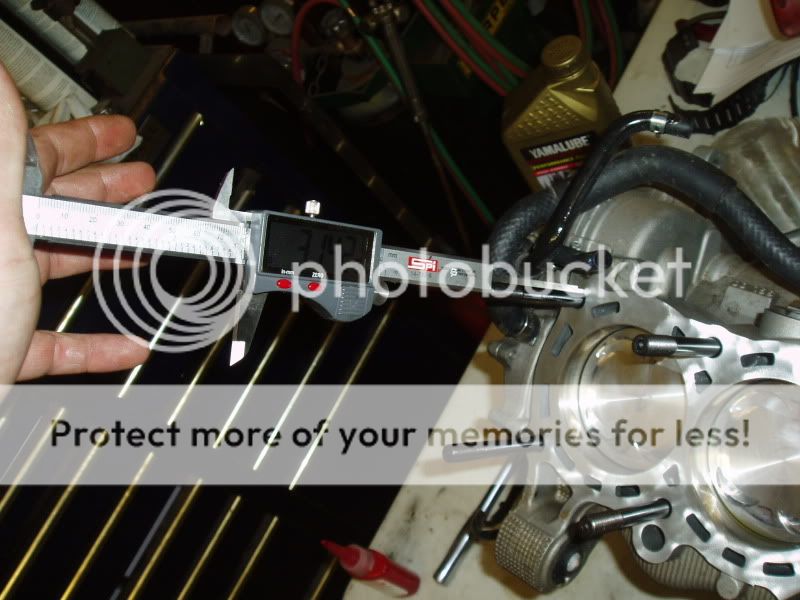

Primary clutch side of the engine and on the intake side of the motor you can only install that stud so far or it will make contact with the water pump impellar and damage the impellar and cause the engine to be unable to turn over.

srxspec said:Also installed ARP head studs. Be careful on the pto top side stud, if you install it too far it can hit and damage the water pump impeller! I measured the depth with a calipers and then measured the length of the stud and subtracted the depth from it. Thanks to Hurrican Dave for telling me to watch out for that head stud! I then used a calipers to set how far it screwed in as well. I installed the head studs with red loctite on the threads into the block and then just slightly snugged them with an allen wrench. Note both studs on the pto side will stick out further than the rest of the studs.

First remove the original bolts. Clean the threads in the block as well as you can. Check the length of the bolts, adjust the length if ARPene is too long. Grease red Loctite on the threads to be down in the block (remember to install it the right way, it is possible to make mistakes). Tighten the bolts to no more than 20Nm. Let bolts stand for 1 day in a temperate room. Lubricate all threads (not those who go down into the block) with moly grease, grease all slices and surfaces before you tighten the nuts that hold the top down. Tighten to 20Nm first , continue to tighten the nuts in the correct sequence first to 20Nm, then 35Nm, 50Nm, and then finally to 60Nm. When you are at 60Nm then slows to each (one at a time) nut in sequential quarter 1 / 4 turn before you tighten it to 60Nm again, this makes you a nut at a time. You will see that the nut goes a long way past where it was before you slacked up 1 / 4 turn. This is very important as it is this last tension to ensure that the tension in the ARP bolts are high enouf. It is the tension that the bolts are exposed to that hold the top in place. I do not cut the bolts, I added an extra slice of ARP. Nuts may originate from the top of the bolt if the bolts are too long .....
